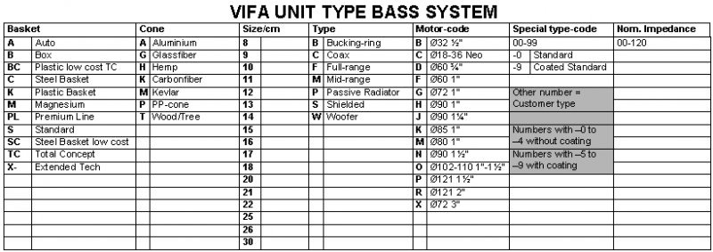

Vifa woofers seem to use this kind of a naming scheme
series, P=classic poly, M=classic (coated) paper, PL=premium line, MG=glass fiber line, TC=cheap line ...
external diameter in cm
W = Woofer or S = shielded device
x = H, O, G, K, R = what is this???
- = dash
two digit number, 08 or 09 seem to be numbers for parts in the general Vifa program, whereas higher numbers seem to be primarily for OEM parts -- is there any system to these numbers?
- = dash
impedance = 04, 06 or 08
example
PL18WO-09-08
So the things that bug me are the letter after the W and the two digit code coming after that.
I have not been able to correlate them to VC former material, size of magnet, type of surround or anything.
Puzzled,
Eric

capslock said:x = H, O, G, K, R = what is this???
It is the drive system ! Including the magnet size and voice diameter !
capslock said:Thanks. Any idea as to what those might mean specifically?
By looking thru their datasheets you'd find out, but here is what I have already found out:
D = 20 mm VC, 210 grams magnet
G = 25 mm VC, 240 grams magnet
H = 25 mm VC, 415 grams magnet
J = 32 mm VC, 415 grams magnet
O = 40 mm VC, 700 grams magnet
R = 50 mm VC, 1050 grams magnet
I'll check it out to find more ...
Here are some more:
X = 76 mm VC, 240 grams magnet
C = 25 mm VC, 10 grams magnet (Neodynium)
K = 25 mm VC, ?? grams magnet (my guess is 210 grams)

Thanks Aggeman,
I guess its the classic line that threw me, as I have a 21WO that has a dual magnet, and another one the has only one very tiny magnet.
A quick check of some of the XT, MG, PL woofers confirmed your scheme.
Any ideas what the numbers after the letter mean?
The 09 seems to be the standard basket for XT, PL, MG lines, 49 the plastic basket for the TG line. However, I have no idea how the basket for the XG18WH00 would be different from that of the XT18WH09...
I think the 39 are usually the non-standard (OEM) versions that have a basked with flat edges, like the Peerless HDS series.

capslock said:Any ideas what the numbers after the letter mean?
I'm not totally sure that VIFA actually knows, or at the very least I can't make sense of these numbers ... so your guess is as good as mine.
Please post it, if you do make sense of it !

Hi guys,
I'm so sorry for waking up a thread this old, but here's what I've learned so far with regards to Vifa model naming:
In the very beginning (1981 onwards), as Vifa continued to manufacture existing Seas designs, their naming convention remained very similar to that of Seas. As an example, the old Seas 17F-W was renamed Vifa S17WF ("W" meaning woofer and "F" meaning ferrite in both cases).
The naming system would evolve over time, and not always in a consistent manner, especially when it comes to basket construction vs. cone material. Troels Gravesen has summed it up like this:
