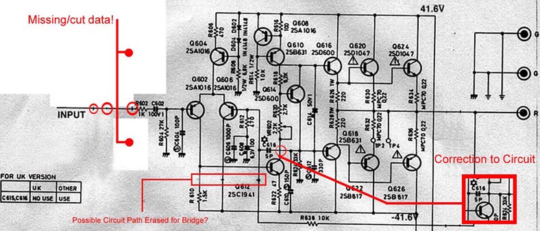

Rotel RB850 Schematic Errors
I have been researching the Rotel RB850 amplifier for several years.
I have compared it to the schematics of similar Rotel amplifiers.
I saw a schematic on this forum that seems to have at least one error.
It looked like a scan of a photocopy that had things erased.
I have redrawn the schematic based on the one on this forum,
similar ones found elsewhere, and my RB850.
I will answer any questions you may have (as far as I know).
There is a thread with this similar question on this forum
Sincerely,
Chris Browne
Ground Noise Industries
Rotel RB850 Marked Schematic
This was posted by member "transducer" and marked in red
by "gni"

Hi Chris,
I replaced the single turn bias adjust pot with a 15 turn unit. . .
I am doing my best to figure out why you would do that.
You should install a new 270° unit at the very least, or put the old one back in after cleaning the slip ring and wiper.
What you people fail to realize is that the multiturn types generally have a much smaller contact area and are not intended to pass DC current.
I'm actually getting tired of hearing about this ill informed "upgrade".
-Chris

The original single turn was a 2.2K - I would eventually like to put
a smaller value unit - 500 ohm. It takes less than two turns of the
multi-turn for the bias go from zero to way too high (30mV).
All this is leading up to:
Front mounted millivolt meters and front mounted bias adjustments.
The problem I found with the single turn was that it would jump
from 6 mV to 9mV in the main area of adjustment. . . Once I narrow
down the smaller value pot. . .sure I can return to single turn. . . I
would want to create some sort of 'enclosure' to protect it.
One advantage of the multiturn is it sits above the main circuit
board so it is easier to get to when adjusting.
Again. I can send the schematic to anyone who needs it. . .or as
Rotel. . .
Just did some critical tests on the amplifier:
Resistor R619/620 and VR601/602 Bias Adjustment.
The R619/620 is a 2.7Kohm and VR601/602 is a 2.2Kohm
single turn trim pot(currently testing with a 2.5kohm multiturn.
Therefore a max R of 4.9kohms. . .
I am going to replace the 2.7Kohm with a 3.6kohm resistor; and
replace the 2.2kohm pot with a 500kohm pot. Therefore a new
max R of 4.1kohms. . . .more than enough to kill all bias.
Spec for bias is 4mV across the 0.22ohm output resistor. . .at that
rate the R619/620 and VR601/602 average 3920 ohms. . . a 3.6k
ohm with a 500ohm trimmer will put the trimmer
at 320 ohms--or about 60% of the turn--for spec bias.
When setting the bias up to 14mV, the R619/620 and VR601/602
average was 3660 ohms. . . the trimmer would only supply about
60 ohms to the total. . . the bias current would be about 64mA. . .
and couldn't go any higher--safer in the long run.

Hi Chris,
The problem I found with the single turn was that it would jump from 6 mV to 9mV in the main area of adjustment. . . Once I narrow down the smaller value pot. . .sure I can return to single turn. . . I would want to create some sort of 'enclosure' to protect it.
We used to call that "Yamaha syndrome". :D Any guesses why?
Anyway, I've done what you are suggesting a few times when the design team allowed too much range in the adjustment. Not everyone was so sloppy. They do not need protecting either. The problem is the buildup of oxides. This is easily prevented with some contact cleaner. The area of trouble is in the metallic contacts.
So, install good 270° controls and be happy. You may need to clean them in 20 years I guess.

I have two Yamaha M-45s with the "Yamaha syndrome!"
Drives me crazy setting the bias. . .it just seems to drift with the
wind. . . any air exchange in the amp case and the bias drifts again.
My M-45s don't like metal adjustors. . .just getting one close to the
trimmer and the bias changes. . . .
Just blew out the right channel in one of my M-45s. . . need to add
test points. . .dropped alligator clip on exposed jumpers. . .pop. . .
that was it. . . need to add protection to jumpers. . . another thread.
Might just put a fixed resistor in place of the trimmer and let the
bias drift a little. The resistor is 2.7kohms with a 2.2k trimmer.
4mV is spec for the rotel RB850
Right Channel (total Bias Resistance = R620+VR602)
3870 ohms produced bias of 4.1mV (18mA)
3608 ohms produced bias of 14.2mV (64.5mA)
3476 ohms produced bias of 22.4mV (100mA)
394 ohm difference from high to low
Left Channel (total Bias Resistance = R619+VR601)
3970 ohms produced bias of 4.3mV (19mA)
3709 ohms produced bias of 14.0mV (63.4mA)
3578 ohms produced bias of 21.9mV (995mA)
392 ohm difference from high to low
