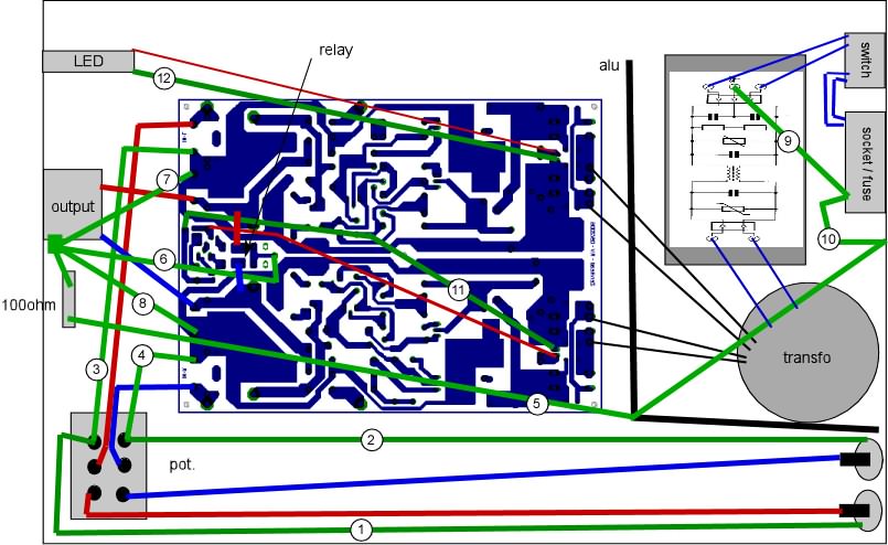

Hi all,
Seems I need your help again...
I've lowered the bias current to 150mA.
I connected the potentiometer the wrong way; the volume decreases instead of decreasing when I turn the potentiometer from left to right. Well it's a minor problem for now.
I tried the amplifier with an headphone (balance not adjusted yet)... and realized that there is a big 'noise/hum'.
I made a scheme of the ground connections in order to see if there could be a problem there. The numbers refer to:
1. Ground right input (connector to pot.)
2. Ground left input (connector to pot.)
3. Ground right input (pot. to pcb)
4. Ground left input (pot. to pcb)
5. Ground resistance to case
6. Ground to mute outputs (relay)
7. Ground right output
8. Ground left output
9. Ground socket to filter
10. Ground socket to case
11. Ground (12V supply for relay)
12. Ground (12V supply for LED)
There is an aluminium sheet between the transformer/filter and the main pcb. It's connected to the case.
I cut the connection '4' between the potentiometer and the right input (pcb) but the hum is still there. Is it ok to keep the ground between the input connectors to the potentiometer or should I wire it directly to the ground-inputs on the pcb?
Another point is that the heatsink (where the transistors are connected to) is not connected to the ground. Should I connect it?
These are the things I'm thinking of...
What is your opinion regarding this wiring? Or what do you think I should do to stop this hum?
In case, the amplifier can be seen HERE .
Thanks in advance for your help... and have a nice end of weekend,

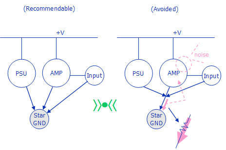

r_jik45 said:
But I thought that maybe an obvious mistake could be seen . . .
Understood . . . :D
From the picture showing your PCB board, I assume that PSU and AMP are there all together in one board. It means that AMP's grounding path might be mixed up with PSU's grounding path carrying all dirty electrons before cleaned up. By using a small knife or a sharp tool . . . I would cut off all PSU grounding path and separate it from the AMP's grounding path, and send the separated grounding wire of PSU directly to the star ground.
I hope this will help.
hi
I agree with Babowana.
Hum is the sound of remains of 50Hz ( 60Hz ) from MAINS AC.
Sometimes, Often! ... this is doubled to 100Hz ( 120 Hz ) after rectification and power supply filter.
Amplifier amplify.
So even quite low levels of this 100 Hertz
reaching input
will be possible to listen to, hear, in speakers.
When is a hum
we will try to see: in what improper way is Sound of TRAFO
getting into contact with INPUT transistor.
Sometimes, in small boxes,
and especially when you use NOT toroid trafos
it can simpy be Trafo being too close to amplifier board.
Or too close to some wire, that is connected to input.
Babowana is having a fair idea of the cause.
Based on what we can read in this forum,
9 times out of 10
-- this hum is is transported
via GROUND ( 0 volt ) wires or PCB tracks or Metalbox, amplifier case
from TRANSFORMER ....... to INPUT of amplifier.
Cutting and re-arranging 0 Volt / Ground wires
will fix these issue quickly in those 9 cases.
Case number 10 out of 10 is the more mysterious one.
But also this will be solved, if not by brain and experienced helpers,
so by trial-and-error method for fixing.
lineup - haikku haikku
Thanks to both of you for your suggestions/comments.
For the 0V - signal ground connection, it seems that they are also connected on the original board proposed by Tortello. I will try to see if I can 'cut' it somewhere... even if I do not really know how to make the difference between them :xeye:
Regarding the position and possible interaction/interference between the 50Hz source and the inputs: I will try to isolate them better. The transfo is indeed close to the inputs... but there is not much space to do organize the parts another way.
And what about the fact that the input-ground is connected directly to the potentiometer? Is it normal that way?
Anyway thanks again ;)
