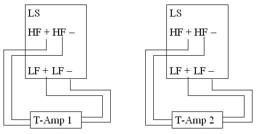

So you want to bi-amp/bi-wire your system? You want more power, right? So do we all. But this will NOT get you much more power. Just a tiny bit more. Still, it's a good idea and can sound nice. With T-Amps it is not expensive to try.
Here is how to do it:
You use one amp channel per section of the loudspeaker. If you have a 2 way speaker, you can use the left channel to drive the woofer and the right channel to drive the tweeter. So you would need 2 amps for a stereo setup. With a 3 way speaker you need 3 amps for stereo. (6 channels)
Your speakers must have separate terminals for each section. With the small T-AMPs, (AMP3, AMP6, Sonic Impact, Charlize, Super-T, etc.) the grounds must NOT be common. So you have two posts per section. 2 for the woofer, 2 for the tweeter. Connect the amp channels one to the tweeter and one to the woofer and Volia! you are bi-amped.
How to run the inputs?
For the simple passive crossover type system (in the speaker), you will need to split the input signal so that it goes to both the left and right inputs on your amp. That is because the filter is after the amp, in the speaker, so each channel gets the full range signal. One amp will get Right, the other will get Left.
It is easy to split the signal, just run one wire to each input cap from your volume control. Or run directly from the RCA connector if you are using a preamp. Keep your wires short.
That is a passive bi-amped system. You don’t get more power, but you will get more channel separation and isolate the tweeter from the electrical circuit of the woofer.

Hi guys. My first post.

preiter said:
Bi-amping using T-Amps is no different from bi-amping using any other amps.
It is a little different because the small T-amps are bridged.
So it is important to stress that the negative terminals can not be tied together, nor to ground. Same for any amp like this. Also important to note that the Tripath chips will need 2 input caps even if you are splitting the signal.
Otherwise it is the same, yes.
