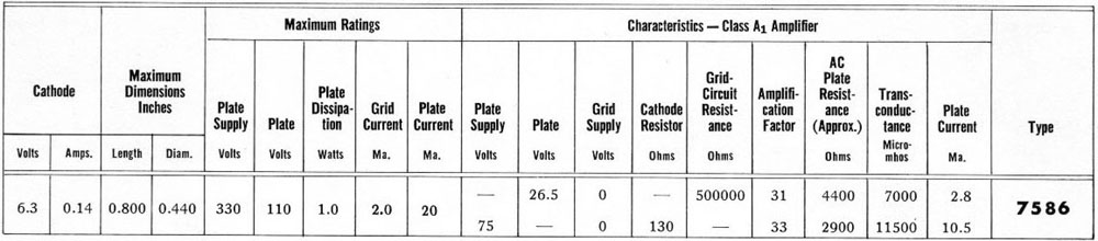

http://www.mif.pg.gda.pl/homepages/frank/short/001/7/7586.gif
think of that tube as a smaller 6DJ8
even if S is on high side,that tube is somewhat wimpy for line preamp-if you ask me.

I'm still not quite clear as to why they would be microphonic though since the 7586 is used in quite a few Neumann and AKG mics.
I don't have an clear analysis about why Nuvistors tend to be microphonic. The mechanical resonances in the elements of a Nuvistor will be at higher frequencies than the mechanical resonances in larger tubes, and the resultant microphonic sound may therefore be more irritating, even if its magnitude is no higher. My recollection of the sound of the Nuvistors that I played with for audio (mostly 6CW4 if I recall) is that they sounded very “zingy”. Part of that sound might have been due their inherently non-linear nature, but I suspect that it was more the microphonics I was hearing, because a gentle tap with a pencil created related-sounding effects. This is not to say that such a tube can’t be isolated and shock-mounted – they certainly could be, and should be for audio.
In microphones the size advantage of a Nuvistor is just too tempting. I’ll bet most of the tube mikes you’ll see are not intended for hand-held use. Typically studios suspend these kinds of mikes in an elastic suspension. And I’ll wager that the Nuvistor inside is well isolated and shock mounted. I once had an ancient Neumann U47 that had a Telefunken V14 tube inside. This was a large, though squat, metal-envelope pentode wired as a triode. As I recall, even this large tube was suspended in a shock mount inside the microphone’s body.
The site appears to be currently down but the technical library at http://pearl-hifi.com contains an excellent downloadable PDF on tube microphonics which correlates frequency and amplitude with grid. (Real men use acorns anyway. )
Brian wrote
'Nuvistors are typically not as linear as their noval-based brethren. The mu of a 7586 can easily vary by 2:1 over signal swing, where a 6DJ8/6922 will vary by less than 1.25:1 (rough figures). They're cute, but I would generally choose a glass tube instead.'
This is what has always put me off: I have yet to see a nuvistor that's anywhere as linear as a good conventional triode. If you want to go small the 955 and 958A acorns display exceptional linearity.
