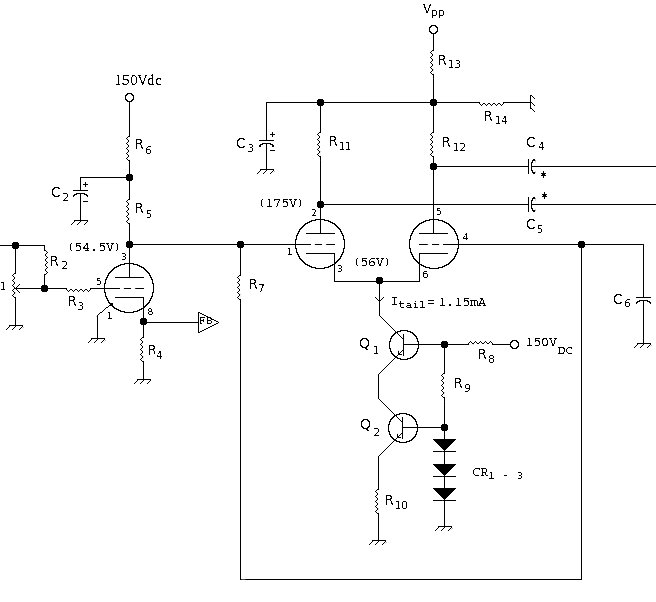

I'm about to build an ECC81/12AT7 differential phase-splitter and I am looking for a simple and cheap (and european aviable) CCS like the LM317, but in the range of a few mA.
Any ideas ?

For something like this, just cascode a couple of BJTs. That's what I did (shown here). The two BJTs are MPSA42 high voltage, video amp, types to avoid possible poofage by overvolting. This works with two sections of a 6SL7 to form a differential phase splitter. Simple, and it works just great in maintaining both amplitude and harmonic balanve between sections. A 12AT7 will require a bit more current than a 6SL7, but still under 10mA. Keep the grids near ground, and add a negative rail voltage of about 20Vdc, and just about any small signal NPNs will get the job done.

bembel said:I got a big bunch of BC337, otherwise, I was wondering what was the difference between: bipolar , FETs , & ICs
BJTs work better as a constant current source than do most FETs. The current stays more constant with voltage variations. Also, since the BJT is a much higher gain device, the impedance of the BJT CCS is also higher. An IC would have even higher gain, since it's usually composed of several BJT gain stages. Cascoding the BJTs is helpful in getting the impedance up, and helps to avoid high frequency AC from flowing around the CCS. An IC is a good way to go, but I didn't have one, and did have the necessary transistors, so that's what I did.
I mean, how does the impedance of the CCS affects the circuit ?
The higher the impedance, the better the balance, both AC as well as harmonic distortion, and the higher the CMRR, which is important for rejecting whatever noise may be coming from the CCS in the tail.

No easy answers there. If you need something with a low drop out voltage, then some of the aforementioned ICs would probably be the best way to go.
bembel,
I take it that your LTP splitter is not directly coupled to a previous stage, as in Miles's circuit? If it is, then you clearly don't need a negative supply.
What you could do, to avoid having a negative supply and also to give yourself a wide choice of CCS types, is to raise the grids (and coupled cathodes) above ground potential.
You can do this by arranging a potential divider from B+ to ground, using high value resistors of several hundred kilohms. Connect the "grounded grid" of the long tail pair (LTP) to the tap on the potential divider and also a capacitor (say 0.33uF) from that grid to ground (so that it is still grounded as far as the signal is concerned).
Then you need to have a 1Meg resistor between the two grids of the LTP, so they are at the same potential. The existing resistor betweeen the input grid of the LTP and ground must be removed. You will also need to use a coupling capacitor (say 0.047uF) as input to the LTP, since its grids are now elevated above ground potential.
Choose the resistors in the potential divider to give enough voltage at the grids and cathodes for your choice of CCS. You could even use a pentode CCS if you wanted to.

maybe i can give you some more details about my planned amp:
---> input (with a switchable input cap only used for olds CDplayers with an offset)
---> differential ECC81/12AT7 (B+ 292V Ua=2*146V Ra=2*82k Uk<2V DC-heated)
---> coupling cap
---> EL84/6BQ5 PP (AC-heated ultra linear Z=8k CCS on common cathodes with balance pot (LM317 to ground))
---> finaly a switchable NFB to the grounded grid off the diff input stage (throught a 1k/10k divider and a 1nF bypass)
...So Ray's idea of direct coupling (raising Ug with a divider) is very nice, but what about the NFB then ? it finaly add two caps at input instead of the two coupling caps. Also I use an 230/240V isolation transformer and my B+ is limited so I can not raise the voltage so much anymore.
The voltage on the diff stage cathode is <2V for Ik=3.5mA (both halves), so too short for an IC to ground I think.
But I planned to feed the diff stage with DC-filament supply (I don't know yet if it will be 6.3V or 12.6V, but 6.3V will be easier anyway(than adding a separate transformer))
with the positive filament side tied to ground, thus connecting the CCS output to the -6.3V DC filament supply.
Any comments ? do you think this idea of filaments connection suits my needs, is -6.3v enought for IC chips (ixys or LM334Z), and also how big the -6.3V decoupling caps needs to be for two ECC81/12AT7 (stereo so 4*150mA@-6.3V + 2*3.5mA from CCSs)

Also, you might thing hard about that diff amp for the first stage. You'll only get a gain of 17-18 or so, not really enough to make the NFB effective.

bembel,
To answer your NFB question with the method I suggested: The cap on the grounded grid side of the LTP can have a resistor (say, 100 ohm) between itself and ground. Then, you can connect NFB to that resistor, just like you would do if the grid were at ground potential. Also, with the method I suggested, your switchable input coupling cap would have to be permanent.
