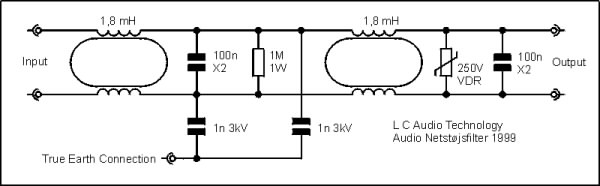

In regards to the input noise you are experiencing, are you using high efficiency loudspeakers?
Is it just a simple hiss (more or less white noise) or does it include lower frequency rumbling, burbling, popping and the like?
If you are using carbon resistors as plate loads you may want to reconsider.. MF and non-inductive wirewound are much quieter.
Also some 6SL7 are quieter than others, so you may want to try some different brands.
I have rarely used a commercial rfi filter that did not seem to have a negative impact on the sound, (And I'll admit I don't know why) yet by the same token similar devices I've built or borrowed using air core inductors and low esr/esl film caps seemed helpful in electrically noisy environments.

The old maxim was if you couldn't hear it from 30cm distance not to worry about it, and yes some noise is normal - and with speakers with 97dBSpl efficiency even very small quantities of noise will be audible at some distance. My current speakers are Onkens + mid and tweeter horns and are around 98dB efficient, my previous pair were almost 103dBspl so I know a little about noise issues.
From what you have described I don't believe you have a problem at all. So enjoy your new amplifier!
