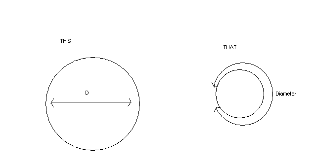

AHm, but the 40liters was 38Hz of FB, 50 liters should be tunned for lower frequency, shouldn't!?
Diameter is like this or that!?
Sorry about the fool question !

-_nando-_ said:Diameter is like this or that!?
[/B]
First. If you have rectangle (a*b) shape of tunel than you calculate half-diametar (Rt) as Rt=sqr(a*b/pi).
