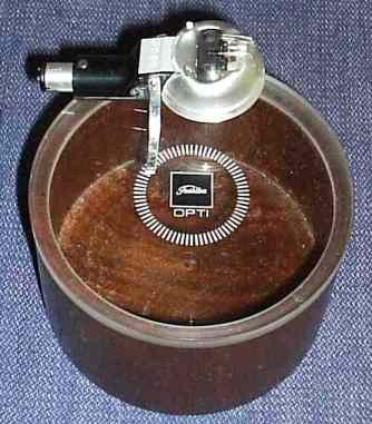

I have just acquired this NOS "Toshiba OPTI" cartridge, which I have been led to believe may be an interesting type in that it used a modulated light beam and photodiode to translate stylus movement into electrical signals.
Does anyone have any info on it, specifically as regards the electrical connections & pinouts?

If this info can help you, I am pretty sure that your cartridge is designed for the Toshiba Opti TR-50 turntable. I think you should try to get info about the TR-50. I was unable to fing good infos on the web yet. If you can find some, I would be interested.

What I have learned about this cartridge is that it requires a special preamplifier, with non-RIAA equalisation, as well as an uncommon input configuration.
The cartridge contains two photodiodes, so does not generate any voltage as do ceramic or magnetic cartridges. Instead, the generator acts as a variable current source, and as such needs an excitation potential. Further, the cartridge requires 2V at 200mA or so to illuminate the phototransistors.

You will be happy to find this bit of info on the Toshiba cartridge.
http://www.badenhausen.com/VSR1Pickups.htm
