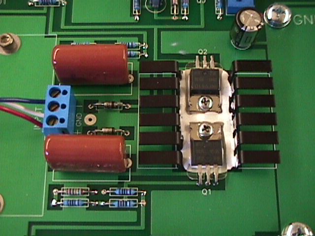

Nelson Pass said:
...but it's kinda messy.
I had been wondering....
Don't they say to apply that sauce "sparingly?"
Why Kapton? It's not a particularly good thermal conductor and tears easily. Its only advantage is its tolerance for very high temperatures, which is not the issue here (the epoxy in the transistor package will go long before the Kapton). It seems that a loaded silicone should perform better at temperatures more typical of audio amps (<100-150 degrees C).
