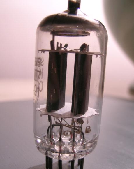

By change I got a pair of milliary coded Simense 12au7. Collecting tubes is one of my favorite hobby and I always endeavor to un-earth the real source of the collected tube as a pleasure. What suprises me is that this tube, coded as "1A1 G4B", with the "G" printed 90 degress from horizon.
I have checked the code list of the Philips Gourp, which shows that G stands for tubes made by Mullard Fleewood and after Feb 22, 1954, Loewe Opta, which seems to be a factory under Valvo.
But there no indication of such a horizontally placed "G".
Anybody knows the answer?

Try posting a better picture, that might help. Pretty obscure question, the people who definitively knew the answer to your question are probably long departed this mortal coil.. :D
The other possibility is that they are recent knock offs by a clever tube counterfeiter. (Hopefully not though.) It has happened to me once, I bought some Amperex 12AU7A on ePay from someone in HK, markings and boxes absolutely perfect, tube though never saw the inside of an Amperex factory. I didn't pay a lot, but I still felt very cheated. They might have been recent Richard**n relabels, but they weren't billed as such in the auction.

Low possibility of counterfeiting
I am always traveling in the most under-developed countries where tube audio is a long forgotten tale and new fever for such fatanstic machines are at the stage of incubation, 'cause modern tube machines won't cost small.
This pair of tubes costs me less than US20, 00 or each less than US 10.00. I bought them from a local shop with a 50-year history.
Sometimes I can buy ECC82 at US 1.00 each. They need not to counterfeit for US 1.00 unit price.
