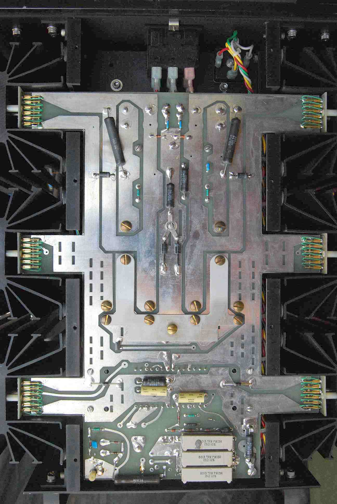

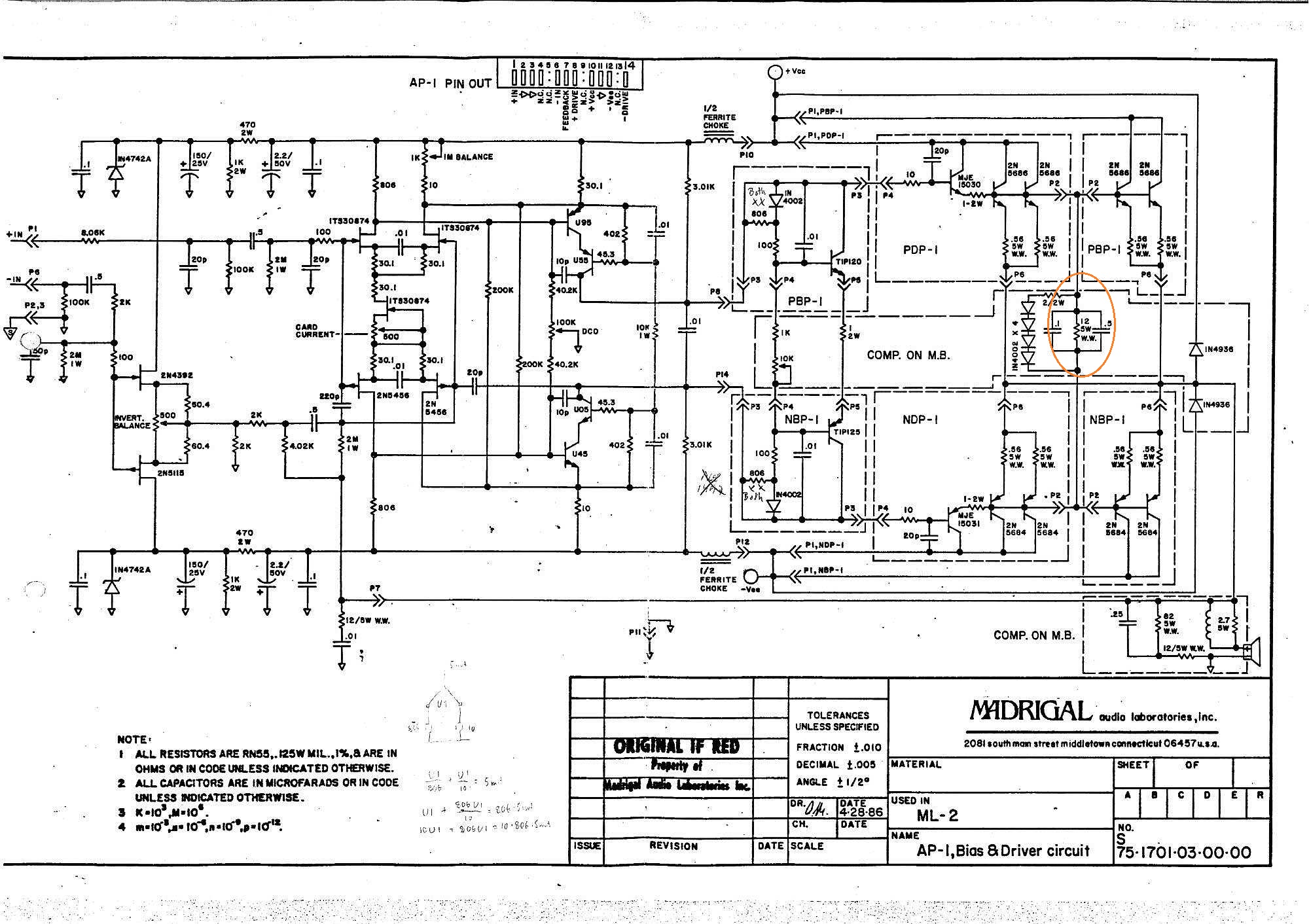

Yes the red circled 12 Ohm/5W resistor that's reachable from the bottom of the amp to 30 Ohm/5. The you will expand your reach with the biaspot and you can get the .56V as specified.
It's the smallest one nearest to the circuitbreaker the one right and somewhat higher then the small cental one.
It has no silver circuittrace beneath it.

It's not really critical, with .50V you still manage 40 Watts Class A, @ 8 Ohms, 80 Watts Class A @ 4 Ohms and 50 Watts Class A @ 2 Ohms (140 Watts AB)
Hello Brian,
If 40watts class-a @8, shouldn't it be 20 watts class-a @4 , 10 watts class-a @2.. ?
No, the ML-2 limiting factor is it's maximum of only 17 Volts RMS output with a 28V regulated rail. It's biased at 4 Amps (when on spec: .56V at the testpoints) en could deliver 256 Watts Class A at eight Ohms when sufficient Voltage was available but there isn't, 128 Watts at 4 Ohms 64 Watts Class A at 2 Ohms. The 64 Watts at 2 Ohms is reachable with 17 Volts at a 2 Ohm load.
That's why Madrigal could get 100 Watts Class A from a no. 20 which has almost the same hardware as the ML-2, because the railvoltage is much higher (or secondaries from the Xformer) and it can develop 35V RMS at it's outputs.
