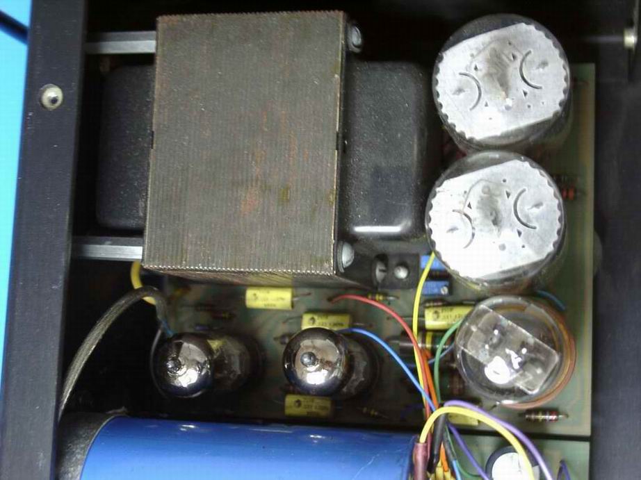

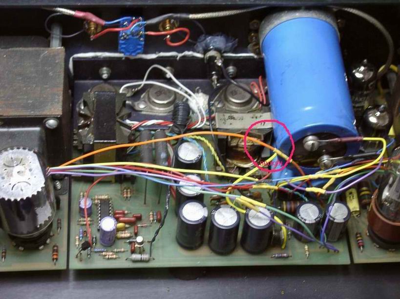

Now I succesfull for fixed my Milbert Car Tube Amplifier by changing PQ35/35 to EI40 choke & step-up ferrite core, I wondered about quality of new core.
I learning its operation and redesigning its PCB (some concept from my master : MR.DAVID LUMANAUW)
I decide for build new Tube CAR Amplifier with 20WATTS Single Ended Class-A : 211 TUBE.
If anybody interested please notice and look this post !!! I shall d o it !!!

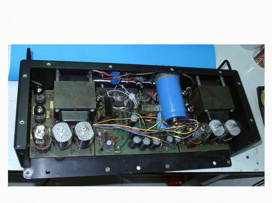

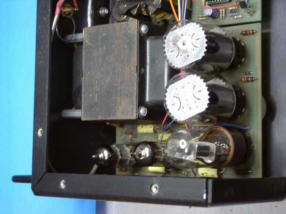

Power Supply Section (Broken Core)
Now I changed PQ35/35 to EI40 (not in photo)
The best concept for me is
1.Carbon resistor for tube aplication
2.High FRQ core
3.Teflon insulated wire
4.Low current power amplifier
5.Electrocube Couping Capacitor (I seen in LAMM)

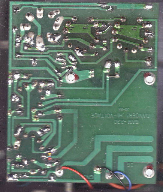

This's Bottom Layer Pcb
I think it's quite complex PCB with output transformer included on PCB.
Could I use EL34 instead of 6JN6 ?
Now I can't drive 5.75" DYNAUDIO 15MA SPEAKER with MILBERT BAM-235, How do I modify this amp for this mission ?

The Milbert PCBs have a slightly different input design (as well as a few values being different) in addition to a ground trace that is also different. Tube heaters are not wired the same as the EA 230, as it's all based off of one 18V supply from the switching power supply. (see images).
Unfortunately the PCB & build quality is nowhere near what you'd expect for what the amps are sold for (I've seen near $2,500 used, I was told by PrecisionMike here $5K new!) and the 6JN6 tubes aren't fixed in place in the sockets - meaning they can become somewhat loose.
I don't have the SMPS layout/schematic; ideally this can be substituted with an alternate source. The SMPS uses 2 custom transformers and provides 4 total output voltages so it's a bit of a challenge. I've been in touch with http://pjlelectronics.com/ as he seems to have a working prototype that can supply the high voltages required.
