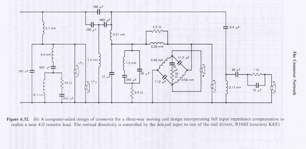

Hi Michael,
You can check out Martin Collom's book "High Performance Loudspeakers". I'm not sure which edition is current, but the 5th edition has the circuit on page 267. It's in the chapter on "systems and crossovers", given special mention on "full impedance compensation".
I never did check the schematic for accuracy against my pair.

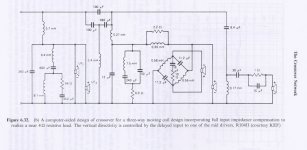

I just happened to have got that book out of the library last week to help with my dissertation . . .
attached is the figure from page 267- took me a while to find a power cable for my scanner, but hey, im trying to put off working as long as possible

Hello again
The scematic that was printed in the Colloms book was nothing like my crossovers. Ignoring the cap and inductor values, there are more components in mine than were on the attached circuit diagram. Thanks for your help though.
I am trying to contact kef service, and the www.hifiloudspeakers.info site looks excellent.
Does any one know how to remove the crossovers from the main chassis. It looks like a nightmare.

I have just found the review I mentioned in the last post. The various "L" "C" and "R's" are indentical and it also suggests a possible explanation for the greater parts count that the earlier posts mention. The diagram in the review has an additional box called an "S-Stop" circuit. The text doesn't seem to address its function but as it only crosses the mid and hi frequency drivers it is probably a protection circuit of some kind. That would certainly account for the additional components mentioned.
Another point that is relevant is this. The review has an helpful "exploded" cut away view of the units and the LF/MF cross over is located behind the mid/hi drivers and the LF components are inside the main box high up on the back panel on a separate board. Neither are in the base so I suspect that you (Clem) are looking at the S-Stop circuit. Also before you go looking for the hi/mid cross-over think twice before you take out the mid drivers. They are not conventional in the sense that they have no support basket. The cone and magnet are located by the precision plastic moulding so if they are taken out you might have the devil of a job putting them back with the necessary accuracy. BTW I hope we are discussing the same speaker. The review I'm looking at is dated Dec' 1984. They were new models in Australia at that time. Good luck.

I have since managed to get hold of the correct scematics for my 104/2s. They are dated 1990, and seem correct.
There were seemingly different derivatives, even a bi-wire version.
I wanted a scematic, so that I could investigate the possibilities of enhancing the performance with modern components.
I have now decided that the crossovers are extremely complex and carefully balanced, and that any fiddling would do more harm than good.
FYI, my crossovers are one-piece and are located against the back panel of the chassis about half way up. It is not easy to see how they might be removed for service without dismantling a lot of the chassis.
