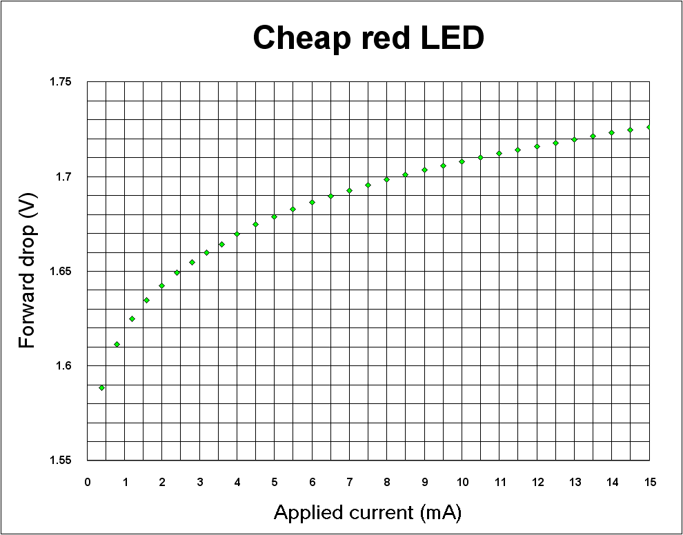

My recollectrion is SY does dynamic testing and chose a red LED presenting an AC impedance of approximately 5 ohms at the current of interest. I've been able to find LEDs good for about 7 ohms, unfortunately unmarked models purchased by the bag for about $1.
In my testing red LEDs had lower dynamic impedance than any other colour at the cost of lower bias voltage. Even among reds the impedance varied by a factor of three. Regarding noise, biased with a constant current source no LED of any colour that I tested had a noise level obviously higher than the the measurement floor of my 24-bit card - in other words more than 124 dB below 1 Vrms.
In my circuits, bypassed by a small film and the layout kept tight, I think they work extremely well if the bias point falls where you need it. I have yet to measure an unbypassed resistor that didn't display a ton of extra low-level distortion components over an LED, but that's a taste issue.
Hello, checking in from Linz, en route to London. As rdf indicated, very few companies list dynamic impedance as a spec; it generally needs to be measured. And, as EC8010 says, the older and poorer light, generally the better. I bought several varieties at surplus (unmarked), set up a jig to test them, then went back and bought a pile of the ones that tested best. But really, for this application, I don't think that there will be much of a significant difference between 4 ohms and 7 ohms, so just buy cheap surplus and avoid anything that is marketed as "high intensity" or "high efficiency."

The 5-8 ohm impedance provides quite marginal degeneration, especially with low mu tubes. Just out of curiosity, I measured the harmonic spectrum of a couple of red LEDs in cathode circuits- well below my measurement limits. All I could see was a few millivolts of fundamental, exactly what would be predicted from the dynamic impedance, i.e., the thing looked like a 5 ohm resistor. Any bypass cap that has a significant effect at those low impedances will likely be more nonlinear than the LED.

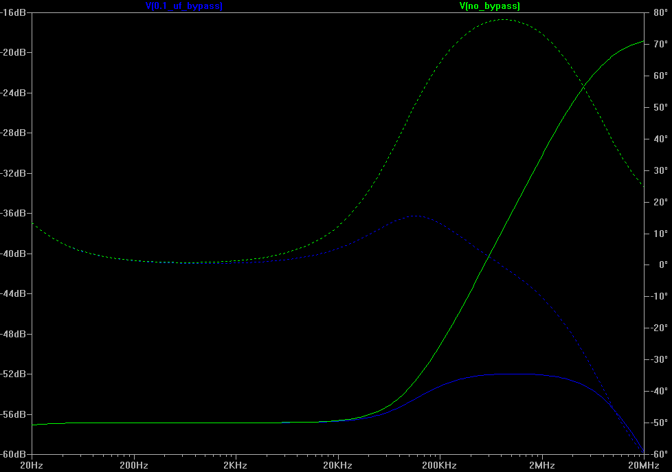

I don't want to claim too much science behind it as nothing I have at home measures very high frequencies. Spice simulations using available models for LEDs suggested their impedance rises with frequency above the audio band. When used as a cathode load this implies increasing cathode feedback at ultrasonic frequencies and beyond. That to me implies the potential for decreasing stability so I shunt the LED and let the tube roam free up there. Neither circuit uses grid stoppers with a very high transconductance tube and neither is at all prone to RF pickup or makes any noise, that's about all of a 'scientific' confirmation for the principle I can offer at the moment and it's not much. It's such an easy thing to try, I recommend giving both a go and find out if it matters for your circuit.
I see that SY posted while I wrote this. What he said! I'm not bypassing at audio frequencies, only ultrasonic and beyond.

Attached is what LTSpice claims as a comparative plot of the cathode voltage for a 6C45 biased at 10 ma with a QTLP690C LED, the latter pulled at random from LT's default library pack. The solid green trace is for an unbypassed LED, the blue represents a perfect 0.1 uf cap, no inductance, leakage, etc.. Manufacturer's specs for most film caps that value show a self-resonance between 10 and 20 MHZ anyway. Possibly 'math gone wild' with no true correlation to reality but it's what got me trying bypasses.
