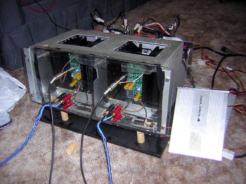

Aleph 3 mods
Hello all,
Mark,
Actually, I built this Aleph 3 on my own. Todd built the previous Zen he brought over last year.
This was my first amp I have ever built with the compliment boards Mark donated to me last year. I have spent a lot of hours on it buying different parts to try in it over the year. So, I would guess hundreds of hours picking what I found to be the most musical components and listening to see if I liked that one capacitor or not etc... I typically would buy three types of capacitors such as a metal film, silver mica, and or ceramic etc...
I did follow a previous thread that suggested Aleph improvements and implemented most of the suggestions on this thread. I would try one mod and then listen to the mod to see if I liked it or not.
More about my specific Aleph 3...
I am using my own custom wound toroids, which sets my rail at about 25.6 to 26 volts plus or minus rails under my very heavily biased load.
I am using 4 68K UF 50 volt capacitors with a 2.5 mH iron laminate core 18 gage inductors in a pi filter network. I am using a MKT .47 UF bypass cap on the capacitor bank. One for each rail. The power supply is a dual mono setup.
I removed the bias resister so that the Aleph runs wide open, which I had to add a fan to the heat sinks to keep it at about 55 to 60 degrees Celsius on the heat sinks. In the future, I would use twice as many heat sinks to keep it fanless.
I used the Aleph 5 feedback resister values and still added less feedback, since my horn speakers do not seem to need a lot of damping factor or control.
The high bias seemed to give it a lot of spaciousness. The other thing I liked from this previous thread was non polar capacitors for crossover networks. I replaced all 3 220UF capacitors in my MikeW Aleph boards, giving it a much more detailed and spacious sound compared to the electrolytics for some reason. I have not bypassed those yet. That will be another experiment down the road.
As mentioned already, I replaced the IRF9610's with the ZVP3310A Zetex mosfets. I found the ZVP3310A added a lot of extra detail compared to the IRF9610's. It was quite amazing at how much a difference it makes changing the input mosfets. I left the 10K ohm input resistance figuring it would have a lot less distortion in the upper frequencies, which hearing is believing. I know Nelson raised his Zen Version 4 to 47.5K ohm, but I felt lower would still give lower distortion still in the upper frequencies Plus that was one less thing to match again to my left and right channels.
I also tediously matched all resister values to each amp so that both channels are the same practically on their values. I have a electronic store that allows me to measure my parts before buying the parts with no extra charge, other than my many hours of time doing that on my own.
I think that was not needed now, because of how much the mosfets can vary while they warm up throughout their range.
The lower ZVP3310A input capacitance seems to allow a lot more of the original signal to get through, without the higher capacitance of the IRF9610 rolling off the highs. There is a night and day difference on how clear instruments sound--closer to real life compared to the more clouded sound of the IRF9610.
If someone else wants to try the ZVP3310, make sure you realize two of the pins are in the wrong sequence compared to the IRF9610. I learned that the hard way.
The neat thing about these mods are that it would be compatible with all of the Alephs out there. So, if you need a more powerful Aleph go ahead with these mods and have a much nicer Aleph with more power if you are unfortunate to not own efficient speakers.
I have a smaller version I have not completed yet, but plan on trying the IRF510 instead of the IRFP240's in the output stage. I guess I would call it a "Super Mini Aleph" of about 5 or 6 watts for my compression horns. I should have 1/5 the capacitance of the mini Aleph, so should hear even more clarity in my horn set up.
I was surprised to hear my first amp (the Aleph 3) actually had 20 seats of additional depth over the well renown Krell. That is quite a feat!!! I have always read the Aleph series have less depth and or spaciousness than other amps, but not in my tweaked Aleph 3 it seems.
With our 30ish year old ears, my brother and I further found at least 30 percent more resolution in discerning instruments compared to the Krell. Guitar strings just plucked right out of the air as though you were sitting in front of a live performance. Voices came out of thin air it seemed. It felt like a veil had been lifted. The spaciousness was truly a 3D holographic sound projection of the concert.
What was so surprising as Mark previously mentioned was even with all of this extra detail, the Aleph 3 still somehow sounded a lot smoother than the Krell. There was no hint of harshness with all of that extra detail.
I would have to let everyone chime in on their own opinions as to what they thought, because frankly the builders of the amps present would naturally favor their own creations.
The Krell sounded nice by itself and so did the Aleph 3. It was only when comparing them directly side by side that I noticed such a great difference.
The Krell really was a nice amp with very excellent bass. Both of these amps would work great bi amping. I would use the Aleph 3 for the highs and the Krell for the lows so that you could have the best of what both these amps excel at. Spaciousness and depth and super detail from the Aleph and dynamic bass from the Krell.
This shoot out is still not over yet. I still have some more mods to try out for the next time.
