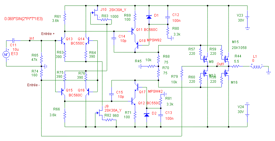

30W mosfet Planteféve
30W Mos Fet Plantefeve
Schematic

Re: 30W Mos Fet Plantefeve
GEirin said:
Recently I found an old article of a power amplifier, 2x30W AB Mos Fet of J.M. Plantefeve.
Has anyone heard of this?
I know the website of Plantefeve from France.
There are some interesting amplifiers over there!
Very minimalistic Power Amplifiers.
I do not know the details of this MOSFET you are asking about.
It uses 2SK1058 / 2SJ152 lateral MOSFETs.
Bias is set only with resistors.
This means you should have very large heatsinks to avoid problems with bias runaway.
Here is a link to original article, with a picture of this amplifier & schematic:
MOS-FET 2 x 30 W
Plantefeve Hompage:
Plantefeve ENGLISH version
GEirin said:
Ok.
R82 and R83 are trimmer pot for adjustament.
GEirin.
That's OK.
You can adjust both offset and bias with them.
Another thing: it has very high gain, are r74 anf r79 correct?
By contrast open loop gain is low, therefore low feedback.
You will have to bias mosfets heavily for low distortion and low output impedance.
regards
