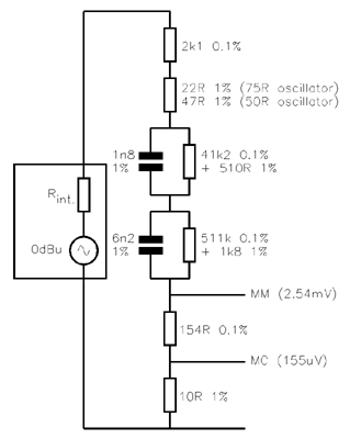

This is my passive RIAA network for testing mm preamps with nominal 47K input. It has an attenuation of 38dB at 1 KHz so it can be fed direct from a cd player. Nominal accuracy is +/- 0.2 dB to 20 KHz.

A few points. Most CD players have an output resistance of a few hundred Ohms and that will affect your response. Your graph seems to indicate errors larger than 0.2dB, but you have the figures. Even so, 0.2dB error is quite large for a design error - let alone once the effects of component tolerance are factored in. Loading capacitance on any inverse RIAA network will effect HF response. Once it exceeds 200pF or so, you will see errors begin to creep in.
This network has a design error of <0.01dB DC to 100kHz (includes 3.18us) and the worst possible combination of component tolerances produces an error <0.1dB.

A couple of hundred ohms output impedance won't have any effect in the audio band.
I tried adding 220pF on the output to represent the higher end of typical cartridge loading and it has negligible effect below 20KHz.
I wanted a reasonably accurate design using common component values that were readily available in 1% tolerance.

davidsrsb said:Simulating EC8010s circuit, it's ruler flat until it roles off with -0.6dB at 20 KHz and -3dB at 50KHz
That's right, it's -3dB at 50kHz to emulate the 3.18us roll-off included in Neumann cutting lathes that protects the cutting head.

EC, I note your circuit is optimised for 50/75 Ohm impedance. Do you have a version better suited for the normal 2/500 Ohm output of ordinary CD players?

pinkmouse said:EC, I note your circuit is optimised for 50/75 Ohm impedance. Do you have a version better suited for the normal 2/500 Ohm output of ordinary CD players?
It's more that the total series resistance before the RC networks needs to be 2197 Ohms. If you knew the output resistance of your CD player, you could simply subtract it from that total value to find out what value of resistance to substitute.

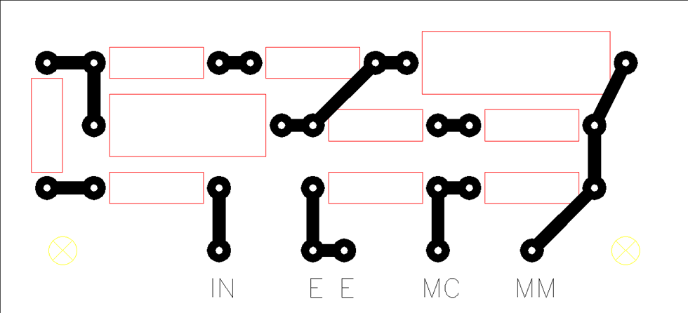

Oh, and to forstall your next question, here's the PCB layout I used...

Your inverse RIAA should be based on the recording curve and since you plan to use it for tesing other RIAA stages I suggest you aim for an accuracy about 10 times better than the prototype circuits. At least then you will know with a reasonable certainty that errors are in the prototype and not in the reference.
This will require resistors to about 0.1% and caps about 0.5% (absolute not just matching accuracy) or better if you can achieve it (I don't know how), but I'm all ears.
Do your best to keep it very accurate. You are only building it once and only one channel.
By the way you can achieve tiny corrections by paralleling resistors many decades apart. The bigger one then does not need to be precision, 1% will do.
