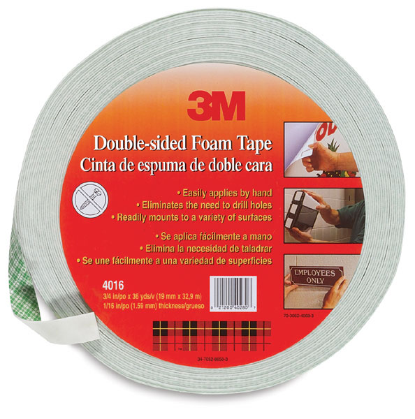

ML used the VHB-Tapes of 3M. As I remembrer they took 1.5/1.55mm or 1.0/1,1mm. For crossover-fregs as high as in the MLs -and the corresponding high mechanical tension- 1.0/1.1mm is sufficient for all instances.
I use 1.0/1.1 in my stators (which are of Sequel size)

to get rid of the old tapes is really a problem. Even 3M themselves have no procedure how to do this. Using a heatgun softens the foamtapes and the glue and rubbing the tape off mechanically will work, but its a pain in the xxx. A solution could be to leave the old tape stick on and just try to pull the membrane off of the tape and to glue a very thin (0.05-0.1mm) new tape on top of the old one.

I'm probably going to sound like a quitter here but here goes:
I got a pair of Martin Logan panels a few years ago for a song. They apparently needed to be rebuilt. I tore one of them apart and worked for hours to try to clean off the three different foam tape types off the metal. After a few hours, I was about 3% of the way through one panel.
I've never seen such fine foam used in foam tape, or such insanely good adhesive. I'd love to get my hands on some.
I lost interest in the weeks worth of work to tear them apart, and eventually I tossed them out when I moved.
I tried heat guns chemical action, etc. The stuff was amazing. I'm impressed.
The stuff would come off, but it wasn't easy.

This foam tape succeeds where others fail. The things you stick up with 3M Scotch Foam Tape stay stuck, because the bond strength actually increases with age.
Foam tape goes a long way, since a very small piece usually does the job. Temperature and solvent-resistant, this double-sided acrylic adhesive has a foam center that's over 1/16" (1.6 mm) in thickness, as well as a 3" (76 mm) core.
