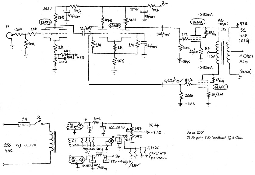

I had the chance to compare a GC with a 3 stage DIY PP 20W classA triode, both made by me. The tubed amp kills the GC in every department. But the GC is way too good for the time and effort. Its certainly cool and fast sounding. For those that havent experienced the GC, I can say that it reminds a lot low powered Naim Audio models for tonality and pace.
