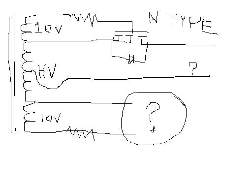

Seems like there would be some painless ways of doing this with special taps, "extensions" more precisely, of the power trans secondary... something on the order of 10 Volts higher (per leg) to drive the gates. The trick being that you would have to avoid waking up the body diode of the FET.
You would need a clear picture of the conducting angle to make sure you had the right amount of gate drive over the range of input voltages and load currents.
I 'spose you could test this easily enough with a second trans with a 1.1 step up ratio...or so. Actually, you could phase 2 heater windings on the secondary to pull this off... just for testing.

Hi poobah,
mmmh... not sure if I got it right (could you be so kind to post some rough sketch?).
BTW, if I understood it correctly it looks a lot like (it is?) a self-driven synchronous rectifier... and indeed it sounds like an interesting idea to start with! :cool:
(I guess you'd need a center-tapped secondary... or do u think this can be arranged as a bridge, too?)

Paulo,
I don't know if I would bother with all this work for rectification. See what SY & EVA say above. Regular diodes can work well. It is a curious idea. Also, I haven't totally thought this thru... just a crude idea and a VERY crude drawing!
I think this would work in bridge or center tapped. Play with the idea... I would use sand...

P.S.: Thanks for the drawing.

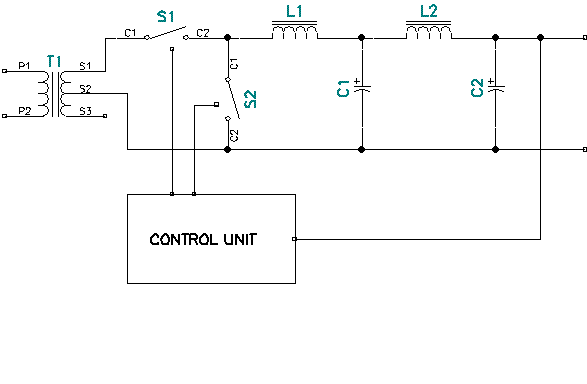

Paolo,
I have derived a topology that will achieve ALL of your requests. It borrows heavily from resonant SMPS design. I have not derived a control strategy or transfer function... and this would be most difficult. Nor do I think it would be practical to implement; I do not agree with your assesment that post supply regulation is so bad for the sound... a capacitor can fix that.
However, if you are genuinely interested in the mental exercise, I will post a drawing and an explanantion.

OK,
I have shown only one side of the circuit... it must be doubled for full wave.
Conditions: Steady state, Inductor is "dry" (no current), both switches are open, we start at bottom of sine wave (theta = 0).
1. Switch 1 is turned ON sometime AFTER the primary voltage is greater than the voltage of C1. Because the inductor has zero current, the current will build in a SOFT manner. Volatge on C1 will build because of charging.
2. When the voltage at the primary passes the peak of the sine wave, it will fall until Vprimary = VC1, at this point; S1 is opened and S2 closes.
3. Current in the inductor will decay to zero, The tail of the decay will be SOFT.
4. When the current in L1 equals zero switch 2 is Opened.
Wait and then; back to step 1:
** C1 and L1 must be chosen to have a resonant frequency... maybe about 10 or 20 times more than 120 Hz.
** L1 must must run "dry" between cycles.
You are on your own to do the State-Space math -
:D

Here is the schematic:
Oho!
This may be somewhat like what I had in mind... or it may be not (well, I guess it all depends on the L/C values and on what you put in the control unit! :D ).
Anyhow, I was not thinking about a resonant circuit, and in my mind the "switches" were connected to a C-input filter rather than to some LC.
Moreover, to keep noise as low as possible I was not thinking about operating the devices like "pure switches" but rather operating them in a "hybrid" fashion (with a bit of fantasy we could name it "soft-switching" mode :clown: ), i.e. letting them be in their linear region for part of the cycle (somewhat like in a "class C" amplifier).
BTW: I don't know much about all the many SMPS techniques... what are the principle of operation and main (dis)advantages of a resonant SMPS?
Well... only something to consider... mental exercise; but you DID ask.
