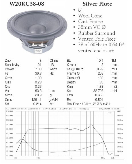

W20RC3808 20cm 38mm Wool Cone 91 100 8 7.3 .92 18 31 83 1.3 .28 .23 ±5.0 183
this is a driver soounds surprisingly good and cost very little ;)
It's a silver flute go to solen and you will see it there.www.solen.ca

newfinish, I'm checking that Silver Flute now!
