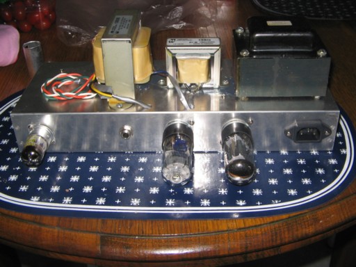

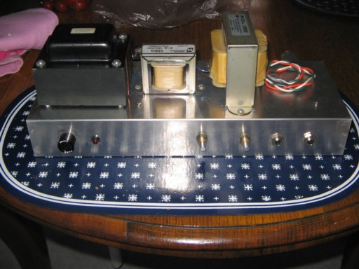

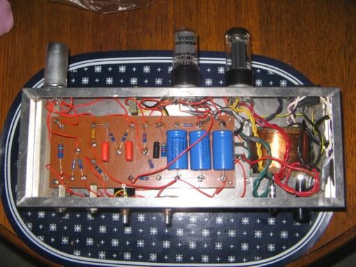

Ive finally finished my first amplifier!, Its a Fender princeton 5F2 circuit and I love it!. Makes my new blues junior sound ordinary in comparison and also hisses and carries on alot less. Im using the speaker in the blues junior at the moment and it makes the amplifier rattle like ive never heard it before, im guessing the reverb tank and/or the springs holding the power tubes are to blame. The only real problem im having is the tone pot does nothing at all and im not sure why, could i have destroyed it somehow? It seems very loose and easy to turn compared to the volume. Its definitely wired up properly so something must be fried somewhere (im sure its the pot). Even without a tone control though its still great, thanks to everyone who answered my stupid questions and prevented me from frying power transformers, myself etc etc. My next project will be a 15watter with reverb (goodbye blues junior).

good on ya you one step ahead of me, all mine have been "sand state" so far! not knowing the circuit power it off! and use your meter and check the tone pot should get the nominal r value from the outside connections and the wiper the middle connection should act as a divider between either outside connection, varying as you rotate the pot.
another gotcher is the curve of the pot although this would usually be a case of nothing much changes untill you rotate the pot to either extreme. ie log vs lin.
rattle whats rattling?

Might not be a bad idea to just switch it to the 5F2-A setup. If the 250K pot is questionable. The 5F2-A uses a couple less parts and (2) 1 Meg pots.

The blues junior just doesnt have the bass like the little princeton (I can play with the tone controls all I like but it just cant come close), it has a much thinner sound and it doesnt respond to my playing as well either. Also the princeton has less background noise than the blues junior, even with no reverb whatsoever the junior carries on and hisses and makes a racket. Not that the junior sounds bad, I just prefer the sound of the princeton and I can crank it in the bedroom whenever I like and not bother my household quite as much. Its probably also that I built the princeton myself, so im a bit biased....
