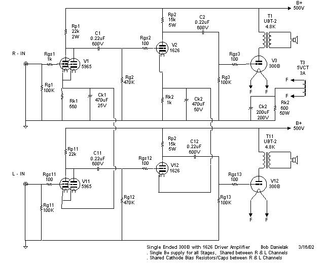

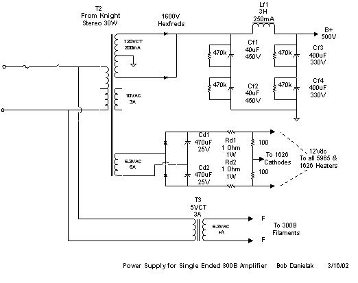

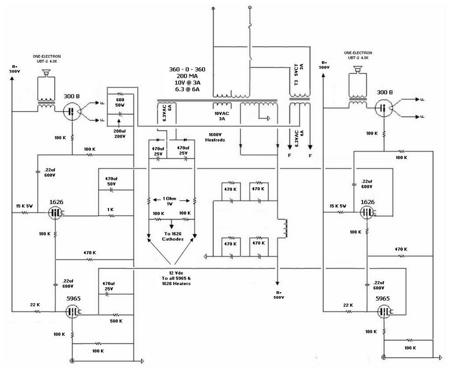

Please review schematic
I found a 300B schematic from Bob Danielak and tried the e-amil with no response. I have some issue's with some 1K vs 100K vs 100 (no K marked), would you experts please review my redraw and help, please.
These are the orginals

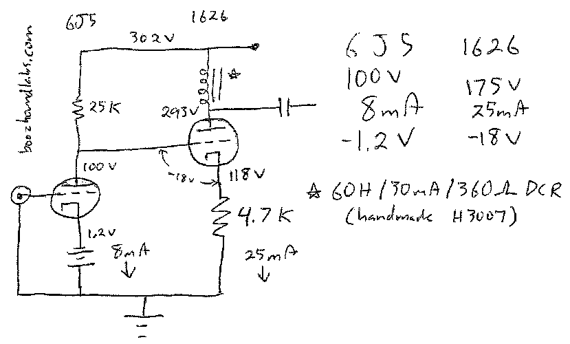

I just designed this direct-coupled 1626 driver for an amp I am building. Very similar to this design, but driver is direct coupled and choke loaded (use cheap 60H/30mA Handmade Electronics choke).
This should be a big bad driver stage - it could be a 1W amp all by itself. In fact, I plan to build it as a DC-Darling amp at some point.
I am using a 6sn7/6j5 as the input tube.
If you do this DC thing, use a 12vct filament transformer for each 1626 and connect the canter tap to the cathode to minimize filament-cathode potential, often a problem with DC designs.

1) The values on the schematic you posted look correct. I didn't see any obvious errors.
2) I forgot to draw a grid resistor in the scematic I just posted. please use whatever your preamp wants (or a pot or whatever). 100k seems to be "standard".
I am working on a followup to my little "hi fi primer" that will show folks how to work through a direct-coupled design and will probably use this 6j5/6sn7-1626 amp as the example. I promise to build it and everythig to prove it works.
