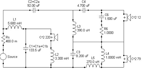

Your filter is a parallel/series hybrid, did you check Tony Gee's website of the "Soup" ?

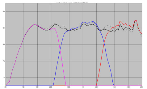

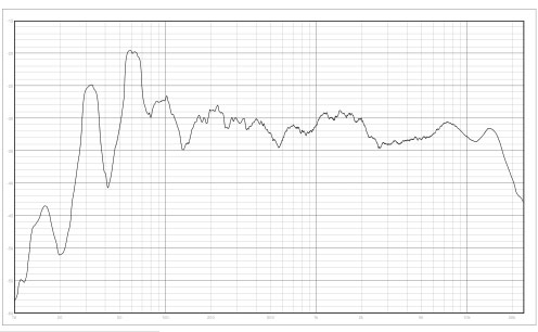

Your freq response (measured), is it done with MLS? Like in HobbyBox?
I use HobbyBox with it's MLS function to blend out the room reflections. That way I measure from 375hz and up without taking the reflections into the measurement. It's then much easier to tweak the filter network and see what "creates"the harshness in your speaker design.
