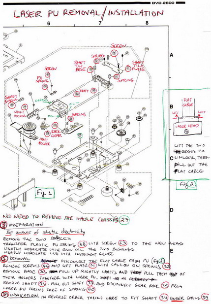

I had the same problem with my DENON DVD-2800 and after replacing the laser PU it is playing like new.
It is very easy to do the job, and the head cost around 35EUR. I attach my notes for future replacement.
You can lift the whole chassis by removing the four suspension bolts (51) and the PU's flat cable and check the part number of the head. It is probably HOP-1000 which is replaced by HOP-1120. On the new head look very carefully (by comparison to the old one) to locate and remove the two babbles which disable the CD and DVD function. Use half a drop of gun oil on the right side rod and a pin head of very light grease on the head at the points it comes in contact with the left rod.
I got mine from:http://www.donberg.ie/

Thanks very much Fiak !!!
I think the 2800 has a different transport to 2900 as the 2800 has no SACD playback....but I could be wrong - please correct me if so.
I'll try the Irish people again - I know them and tried a search on the part numbers I know are used for the 2900 but I got nothing - their site is a bit messy though ;- )
ian
I also got helped by threads in this forum to realize that laser heads loose their intensity by use. Then I took the risk to replace it and I almost lost my legs at the first attempt but it was from the bubbles I had not find, although I looked for one at least, as mentioned at the head's documents. I do not have any records but I do not think there is much deference between the two transports.
It is up to you to decide... :scratch:
Also at those shops they do not know about Denon etc., the head I mentioned is made by HITACHI and - if yours is the same- you have to look for its part number.
