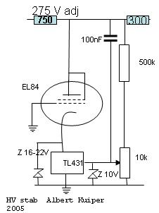

I would use somethinkg like that:

I tried the solid state one with IRF HV fets but I found the thing very sensitive to oscilation.
And the quality of the feedback resistors is also very crucial. With some there is ringing, others not.
I settled with a tube based diagram. The zeners are there for the overload protection of the 431.
As long as this is running before the PS comes up then the startup is very smooth. I use an indirect heated diode and an input inductance. (Otherwise it will want to sustain the HV due to the feedback capacitor.
It works very fine.
The HV can be set with just so much current that the HV net residue completely disappers.
I don't use a smothing capacitor over the whole unit.
This comes after a output resistor. Something like 10 mF should do.

Eva said:I would use somethinkg like that:

jackinnj said:
EVA -- the feedback/ref pin on the TL431 is the error opamp "V+in" -- see the Texas Instruments drawing.
The op-amp in that TI drawing is driving a NPN output transistor that reverses the polarity of the input signal, so actually the input pins work as if they were reversed. Note that my simplified schematic doesn't include that output transistor, so it still reflects the actual polarity with which TL431 responds.
richwalters said:The tube cad doesn't show the pole compensation required for the TL431 otherwise it can nicely oscillate. In the real world this device can behave otherwise and is one of typical omissions using such computer programs. Bread board and suss it out..
