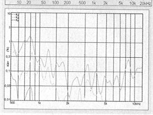

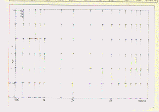

In the 6/02 issue of HobbyHifi, the Neo3 PDR and the Neo 8 were tested. The Neo 3 has good frequency response and good disto.
The Neo 8 has increadibly low disto, second harmonic well below 0.3% for most frequencies above 1 kHz at 90 dB, third at or below 0.03%, fifth below detection (0.01%). Between 500 Hz and 1 k, second is between 0.3 and 1.2%, third still benign.

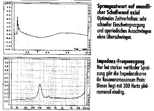

Resonance frequency is 200 Hz, step response looks excellent (perfectly aperiodic except for traces of the 200 Hz resonance). Waterfall just perfect.

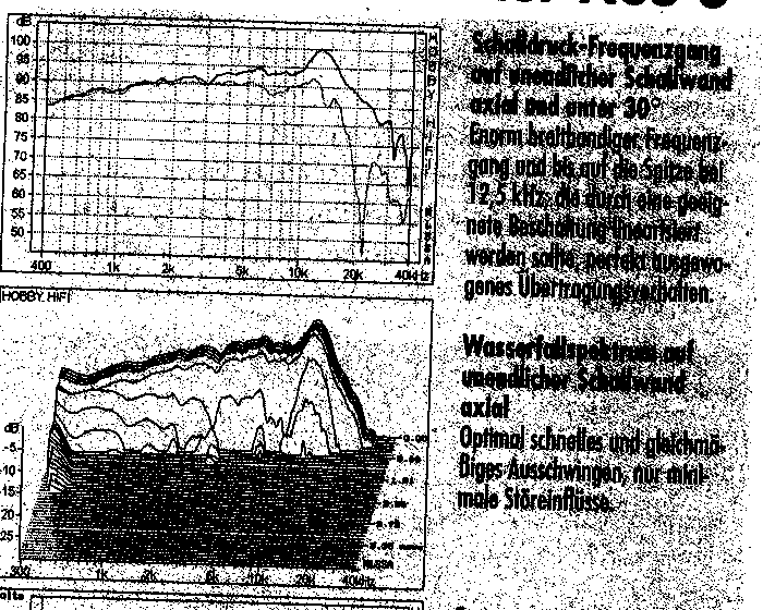

Frequency response rises very linearly between 400 Hz and 10 k by 10 dB, but there is a 6 dB peak around 12.5 kHz. I am not sure how much of this is due to the infinite baffle with unknown rear damping and the microhorn they routed into the 19 mm MDF.
Except for the semi-nasty frequency response, the Neo 8 seams to beat AMTs like the ESS AMT-1 or the Eton ER4 because it goes lower, has lower disto and a better step and waterfall behavior. Only the Manger might be a little bit better in the very low frequency range, i.e. below 500 Hz.
- has anybody used this driver?
- what would be the easiest way to correct the very linear rise out to 10 k?

Response plots from HH 6/02

At least as far as the RD-75s go, I wouldn't attempt to use them over about 5-8k. The Neo drivers, I have not heard. The rising response is easily enough tamed--just start playing with a 6dB/oct lowpass filter. A simple series capacitor will do the trick. Set the 3dB point for where the driver gets 3dB over whatever you consider your target 'flat' response to be.
Grey are you refering to a rising high frenquency response on the RD75 drivers or the Neo drivers? Isn't a capacitor in series with a driver a high pass filter. Wouldn't an inductor in series be a low pass filter. Sorry for the confusion but I am sort of new to speaker design.

The RD-75s are quite flat from ca. 150Hz to about 12kHz or so (I'm quoting from memory). The high end rolls off of its own accord; the low end is excursion limited. If you're willing to listen at low volumes, you can run the RD series drivers somewhat lower. Note that Genesis used the RD-75 in the 1.1 down to (I think) 70Hz, and that in a speaker that played at thunderous volumes. I don't push mine that hard. My comments about fequency tailoring were directed towards calming the rising response on the Neo.
You're quite right about the lowpass filter. I should have said either series inductor or parallel cap.

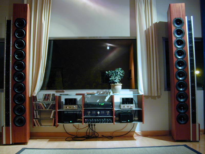

I built a line array using 8x Neo8 per side à la Alpha LS. I hi-passed them at 1500Hz using a Marchand active crossover. They are driven by two Halo SPM25 monoblock tube amps. For the midbass, the Peerless 6.5 HDS midbass (10 per side) is bandpassed between 50Hz and 1500Hz. Two Marchand MB201 amps drive them. The Neo8 are very transparent. They don't have any signature of there own. They just let the music flow. Very natural and only limited by the electronics. The soundstage is so wide, sometime I feel like I got rear speakers playing! I truely recommend these drivers.
Setup: Source: Arcam 9Se Bentaudio TX102 passive preamp
