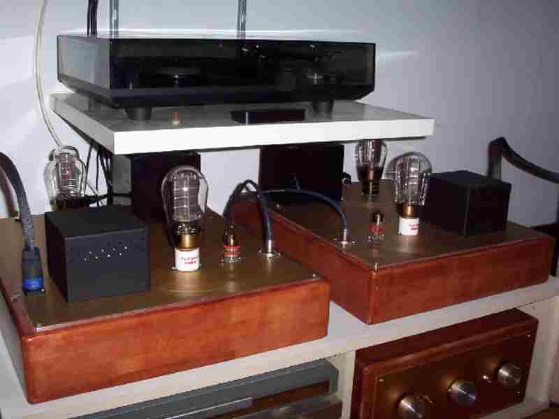

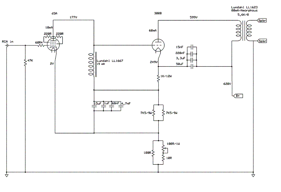

To make a long story short and after a few small “experiments” I decided to build my first serious amp. It was going to be a 300B. Never heard one before but there would have to be something about it after all the buzz that there is around. For a moment I though of going with a kit like the Welborne DRD or the Lady day, which I’m sure it would have been much easier in terms of planning, building and parts collecting…but I decided to build it from scratch. What the hell, I though, do it ALL yourself.
As I said before, I got in touch with Thorsten who very patiently helped me out to adjust the values of his original 437a/300B DRD amp to use a d3A tube in the input stage instead. After a few months of parts collecting and finding the right time to build the this, it was finally done.

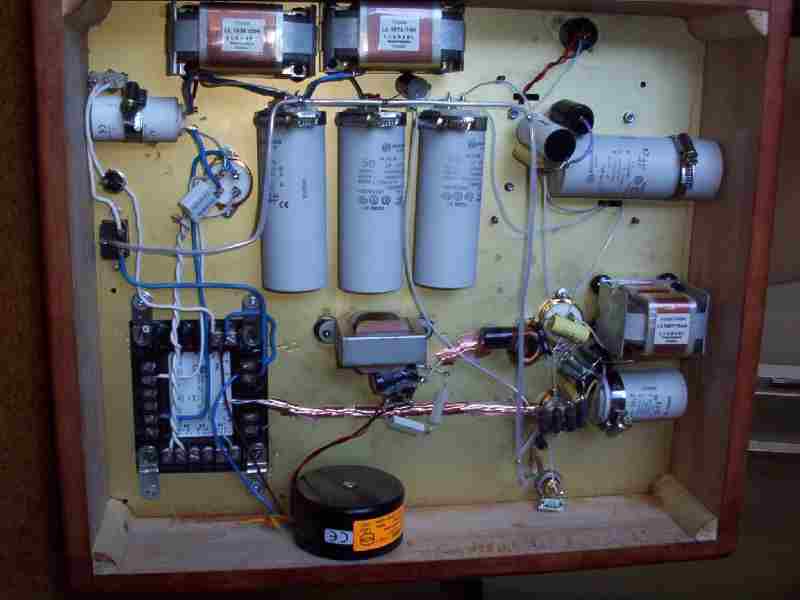

The chassis is pretty big, really oversized. I didn’t want to have layout problems. The aluminum top plates are from Schaeffer in Germany. All resistors on the amp side are Dale, except the 47k input resistor an the 60R4 grid stopper which are Caddocks and the 100R potentiometer which is a Vishay. I might change the grid stopper with a carbon type like a Kiwame or Riken soon. The capacitors on the B+ are Ducati motor-run. Yeap, I can brag about that with my motorcycling friends…electrolytic on the filament supply are Panasonic low ESR. I used Lundahl iron everywhere except the power transformers. I also got a pair of filament chokes from Jack Elliano, one of the guys that brought this type of design to the forefront. Wiring is 26AWG fine silver from Percy audio on Teflon sleeve. Ground bus is 12AWG silver. Input jack and speaker post are Neutrik. Tubes are Full Music 300B and 274A both “mesh” types. d3A are Siemens.
I have to say that due to my limited knowledge of electronics I had a TV repair man friend of mine help me out with the building and testing of these amps. A good idea if you’re are a newbie dealing with potentially deadly voltages.
The Volume control is a pair of copper TX-102s and the speakers were first a pair of Supravox signature bicones that were later upgraded to the field-coil 215-2000 adapted for open baffle.
Sources will need to be upgraded but for now they are primarily a MOTU 896 firewire interface that plays EAC extracted Ape or Flac files from the hard drive of my computer. Vinyl is played trough a Rega P3 with a Denon DL103R and a crappy phono box riaa stage.
Now for the sound of this thing. I mostly hear Jazz and Classical together with some 60s and 70s pop once in a while. A musician I sometimes find hard to believe how some people is so damn “accurate” while describing the sound of this and that component, specially giving the fact that there are sooooo many variables that could influence on the overall sound of a given system, starting with the quality of the recording itself. Well, this amp sound great, really amazing. Trust me guys, I heard not many other amps but enough to know that this is really a special design. First of all there is almost no noise coming out the speakers. Then, when the sound starts happening you always have the impression that you are hearing something that is VERY close to the original; for good and for bad. Awful recording are almost unbearable to hear…a pity because I have to really concentrate on the performance in order to not get distracted by the sound. Why is that? Because the amps sounds so amazing when you feed them well recorded material that it makes the bad recorded stuff look really bad.

ohh nice ... I like these wood/brass cabinets. And I like DRD as well, a very clever idea. I have read lots of positive reports on that topology and I would love listening to them.
From the schematics I see you did use the AM OPTs from Lundahl ... somewhere here on diyaudio a Jap guy (or was it somewhere else??) was saying that permalloy Tamura/Tango are way better than LL. An other great pick up would be a MQ iron. They are not exactly that cheap btw.

Luis.. I like the fact that you have incorporated an of the shelf product LL1667/15mA for your DRD. That makes it a lot easier for folks to build a copy of your amp.

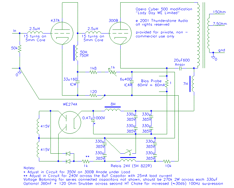

kONNICHIWA,
I'm as puzzeled as you...
I have been using Yahoo groups since before they where e-groups, a long time. So I keep the groups there.... I agree they have disimproved some and look dated nowadays....

Konnichiwa,
This one, in other words....
Sayonara
Raj1 said:thunderstone audiophile group, ladyday signature, look in the direct coupled designs folder.........

I got them straight away. I think I know were you are going. No, sadly I didn't have a chance to compare the Lundahl amorphous core to any other output trannie so I had to go with intuition and faith. Still I'm quite happy with Lundahl. The construction quality is superb and there is many other builders that seem to be happy with the swedish iron.
I'm sure that either Tamura, Tango or MQ are great also...and for sure that I'd love to compare the different sound of each one. On the other hand I want to believe that after a certain quality mark, the sound is not going to change THAT dramatricly from one to another...one hopes.
Do you mean Guido Tent's filament supply? I've heard about it...but as I said earlier, due to my limited knowledge of electronics, I wouldn't know if it would be preferable to the hefty stuff that I have now. I'll have to wait and see what the common wisdom of this and other groups have to say...
