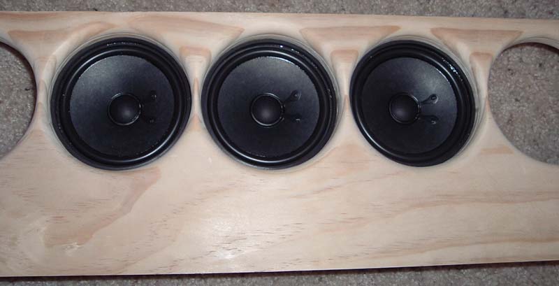

I'm almost done with the baffles on my line arrays. However since I'm using soft wood, and trying to get very close spacing, so I have a crack between two of the holes. One on each baffle. I would just fill it with polyurethane glue, or wood glue and sand it flush, but I'm going to stain the baffle. Would filling it with stainable wood filler do the trick? And will it last? I know i'm not going to get perfection, i'll be happy if it is just not terribly noticable.
I don't think woodfiller is going to offer you any adhesion inside the crack. If possible I would try to use some sort of expanding glue (Gorilla Glue or some other such glue) to fill the crack and provide some stability. Then once the glue has expanded you can sand it down flat. I'm not sure how well that glue will take stain (if at all) but I do know that it dries an amber color.
Yeah, that's polyurethane glue. It's waterproof so i'm sure it's not stainable. Although it may not be that noticable. Here's a pic of the baffle. This pic doesn't have the crack in it though.
