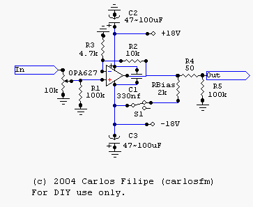

So would a buffer in a seperate box but hardwired into the preamp be OK? Has anyone got a ciruit based on a high quality op amp, say Ad825 or the BB 627 which I could implement on say verio board?
Try this.
Thanks a million Carlos,
Very kind of you. Actually dont mean to take the P@ss but have you got an actual circuit board image of that design. I have recently aquired a old lazer printer from work and i might be a nice project to try and print my first PCB with.
If you havent fair enough i will have a go myself. Been a few years since GCSE electronics and i have a job read circuit diagrams these days but then maybe no pain no gain!!.

AndrewT said:
A word of warning; the ClassA setting will drop out on excessive current. Take care with high capacitance/long cables and low impedance inputs.
No problems, even with 5m cables and 10k input impedance on the amp.
This is not the pre I use on my main system, but I have several boxes laying around here...:D
