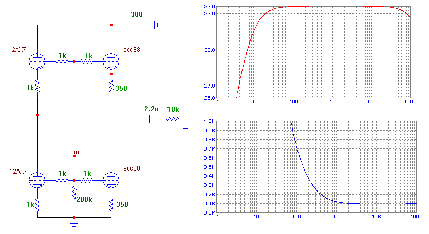

Hi GianMaria, All
I simulated various topologies using your data and
I found that a Gomez with different tube performs
very well.
It uses a 12AX7 in the input/gain stage
and a Ecc88 in then output.
a 300V supply is sufficient to provide
good results: a gain of about 45
and an output of 40 Vrms with 0.4% Thd , but I suspect
that my 12ax7 model id too optimistic.
Output res is good at mid-high freqs. while the
bass performance is not very good due to the coupling
capacitor.
I've attached the circuit with a couple of graphs.

question
Hi fscarpa, all.
I've seen your very interesting simulation on the file GOMEZ.JPG.
UNFORTUNATELY The output impedence will be high exactly where it is needed low: at lower frequencies!!!
So, could we - in that schematic - lead back the output impedance to the same value of the high frequencies (around 100 Ohm) just increasing the value of the capacitor?
What will be the result then at 20 Hz with the new value capacitor?
Could you, or another kindly person, show me the new simulation?
Thanks, suggestions are welcome!
