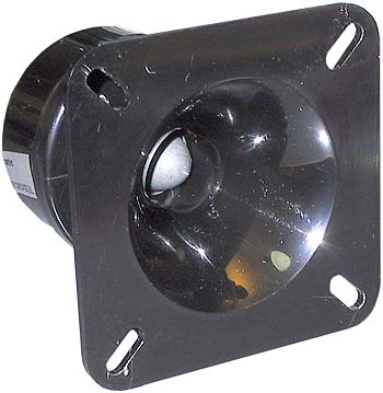

There are probably a number of horns that would work out fine... you just need to find one that will keep up with the 166e. Fostex has a budget horn that likely will work fine. The Foster horn that comes in the Radio Shack tweeter pod is also very nice if you can find some. Even the plastic horned Fosters that RS sold would probably do the trick (i know that the less efficient alnico ones are quite sweet)
dave

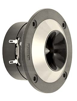

frugal-phile™
Joined 2001
uvellani said:
I use the fostex FT17H crossed over with a .68u PP cap and it gives the fe166 just the right amount of boost at the very top.
That one is commonly used, and is good... my feeling is that it and the RS pod tweeter are very closely related (it is very nice when you find the RS pods for $5/pr at a garage sale :)
dave

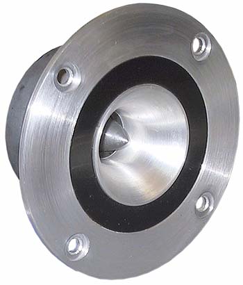

frugal-phile™
Joined 2001
cantskienuf said:
Looks like a "manta-ray" style horn. Perhaps more aimed at the low end of the pro market (that is a guess)... it is an interesting horn i hadn't previously paid any attenion too. It goes at least an octave & a half lower -- which also likely means its top-end extension is also likely an octave & a half less. Since the intended application is super-tweeter for a couple bucks more personally i'd putthe FT17 ahead in the short list.
dave
Impressions
I went with the FT17 and it does add some sparkle; however, I'm not sure just yet if they're able to keep up with the drivers. I used a 0.47 uF Auricap (Fostex recommends 0.33 - 0.68) and although they are slightly used caps, they may require some additional break in. The tweets seem to need to be pointed at the listening position with the horn pointed straight ahead. At some point in the future, I think it would be worthwhile to try a more sensitive tweeter. Not to imply that this horn is anything short of the best speaker I have ever owned, and of course there may be some additional changes with additional hours. Other caps may also result in more high frequency response. Just thought I'd report my initial impression in case somebody searches FE-166E projects.
