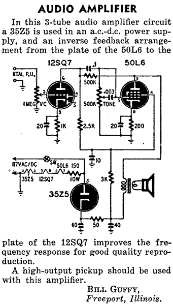

As a generally held belief triode mode is better sounding... recent amps such as the RH84, Gary Pimm's 6AU6/47 PP, & Pete Millet's amp in the latest aXp are challenging that belief.
On the weekend, we converted a Mulligan (SE EL84 triode strapped) into an approximation of an RH84 (using parts on hand). Good enuff that it is going to be updated with proper parts & if long term auditioning verifies initial impresssions the more developed SE EL84 parafeed monoblocs will also be RHed... RH runs in pentode mode... the same feedback trick probably works with ultralinear (ie Peter Wendt)

Using the feedback method which Dave was suggesting may impose a more severe load (lower impedance) to the driver - so was often considered a poorer choice than using global feedback from the secondary, as is commonplace now. It is most certainly not new - I just was browsing through the "Has anyone built this amp?" thread, and noticed something (this is apparently a fairly typical circuit for a '40s valve radio)
http://www.wkinsler.com/radios/5tubeamp.html
Notice R8?
Anyway, back to the original question - all of fixed screen (pentode), ultralinear, and triode mode have good and bad charateristics. There is no "best" choice.

Certainly isn't... i'm slowly scanning interesting articles out of my 1940s radio-Crafts and see it fairly often... an example attached.
dave
