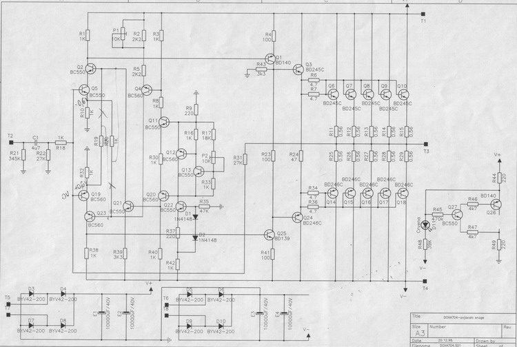

Do You or anyone know what BIAS current normally is on a Doxa 70? On my Doxa 70 i measure 3,5mV over emitter res.(After 1/2 Hour,without any load)
Emitter res is 2 x 1R in parallell giving me around 7mA!!.
Please advice me as i need to know :)
I am draw schematic doxa 704. Maybe i made mystake. Resistor on th eemiter of input transistor have wrong connection. I put, i think corect schematic.

schematic clarification
do you know what should be the output on the transformer? 32V AC? also I would like to know What each T(*) means as a connection. There is also a missing connection on the right between Q26 and R49. And a floating connection D6, D10, E3, E4( is that ground?
thank you,
