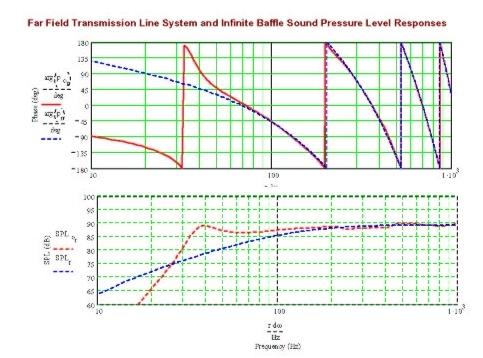

I plan on trying out the H1144 (T18 Coax) in a ML TQWT.
Below are models of it in MJK's Fostex FE-164 enclosure, with double the stuffing; I'm liking what I see.
This is a textbook simulation, not very useful in real life! You should read up on filterdesign if you want to design your own speaker. If you just want a good working design, build something an experienced designer have made.
Also, remember that the the speaker shape it self is a part of the filterdesign. If you alter the dimentions of the cabinet, it will affect the filter response.
Edgar
I have never tryed this simulator before, but judging by the values you got, it's pretty close to a textbook filter. Have a look at at L2, it is way to small, it don't compensate for the baffleboost!
It's a long way from this filter to a good sounding filter, but if you want to learn how to design a speaker, it's good as any startinpoint.
Btw, the link i gave is not my design, it's the design og Stig Erik Tangen.
Good luck
Edgar
