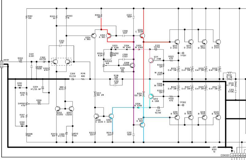

Just out of curiousity, when designing an amp, how do you determin what values to make the emitter resistors? and what effects would there be if you altered those values within an amp (not that i would, its just for discussion).
For example. an amp i am working on that has 4 pairs of output devices and uses 5 watt 0.47 ohm emitter resistors. How critical is this value? what if i substituted 0.33 ohm, or 0.70 ohm etc.
What effects would there be if the value was changed. up & down???
again, this is for discussion only.... I found a source for some 0.50 ohm resistors which i figure is close enough to 0.47 to not have any ill effects. but this got me to wondering what effetcs various changes in values would have??

Higher emitter resistors add a little feedback, helping to keep the quiescent current constant with temperature, and in the case of parallel devices they help share current equally. If you're having difficulty setting a stable bias you may need to increase their value.
They also increase distortion and output impedance, so you want to use the lowest value you can get away with. For BJTs 0.1 is a good choice. I would avoid going below that, or above 0.47. With MOSFETs it's often possible to do without any at all.
If you parallel mosfets, you need source resistors to current share. Not unless you plan to match the darn transistors really very closely. Take it from me as I've had to do this. If you add a little feedback, the source resistance becomes less of a problem. I'm talking 6~12 dB, depending on the circuit.
I'm kinda partial to 0.22 ~ 0.33 ohms for BJT's. Again, depending on the circuit and voltages. The heatsink size also determines how stable an amp is for bias.

The Amps i have been repairing are Bass Guitar amps, so the value was probably chooses for stability under extreme conditions VS. Ultimate sound quality.
The value sounded High to me. I am used to seeing 0.1 ohm or 0.33 ohm commonly. so i wondered what effects the values would have.
How does an emitter resistor add feedback to the circuit? I understand how current sharing happens, but not feedback per se.
here is the circuit i have been working with.

Mr Evil said:They also increase distortion and output impedance, so you want to use the lowest value you can get away with. For BJTs 0.1 is a good choice. I would avoid going below that, or above 0.47. With MOSFETs it's often possible to do without any at all.
The higher resistors doincrease distortion IIRC from Doug Self, but this seems contrary to logic as they should provide local degenerative feedback, linearising the device.
The output impedance is barely affected because they are within a local feedback loop and within the global feedback loop. The issue is that higher resistors limit the max power output due to their dropping more voltage at high current swings close to the rails.
Be careful using the word MOSFET. Vertical MOSFETs still require resistors, only lateral ones with their -ve tempco at starting low currents can be used without.

Hi kanwar,
You are dancing with the devil. I have experience with what you are doing and can tell you the fets are not sharing current that well. The neg. tempco does seem to start to come in around 50C, so that is what is saving you.
I don't care how many you built that are working, that just means they don't blow up. That's good. The question is on forced current sharing. You would have to put sense resistors in the drains and measure them to prove this.
Case in point. Counterpoint SA-220 has four pairs per channel. Just try and stick non-matched sets in. They will not last. Reason: no source resistors, IRF devices. If you pull the original parts out of one, you will find they are matched unbelieveably tightly. That's what you have to do to get the job done right.
