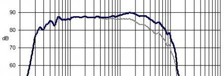

I haven't seen the plot on Zaph's site and I was refering to the hump on the data sheet.
The large inductor will start the roll off further back than the start of the hump and in the graph, the blue line is a 1st order crossover at 2000Hz (0.52mH) and the grey line is at 900Hz (1.2mH). Didn't work for me but I was using a series xo.
I didn't find a zobel necessary as the inductance in the woofer is very low resulting in a gradual impedance increase. A zobel can work well doing just what you have in mind as I have just done that on a Peerless 830875 to tame a peak at 4000Hz.
I've not had a problem listening to reversed polarity in tweeters and BTW, that's needed a lot in first order crossovers as well and some 2nd order have a normal connection.
Cheers

Thankyou indeed !
Thanks rabbitz for all your comments and especially for the comparison plots !
I would normally only use a Zobel in an application similar to the one you mentioned , and I'm pleased that one is not necessary with the 18W .
If I go with this project I'll first try a couple inductors of values in between the two you plotted , to get close to what I'd prefer , and have a listening prototype to evaluate .
