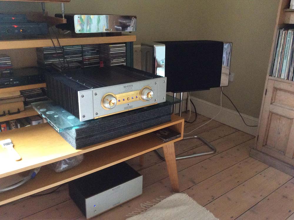

I have recently overhauled a pair of 401As, and implemented almost all that Bez listed ;). In addition, I added a fair amount of vinyl damping pads on the cabinet walls and braces, as they tend to ring when rapped. Cleaning the pots, bypassing the fuses, damping the large cabinet and replacing the caps all help update the sound.
The pair I purchased had almost new replacement foam surrounds. There are a fair number of Gales in Singapore, as "DW" of DW Labs, who manufactured later Gale models, I think (402A) is based here. DW and many others strongly suggest sticking to foam surrounds. There's also a suggestion that new foam surrounds are much less prone to "self destruct" compared to the originals.
At the moment I drive them with something totally incongruous -- a DIY 25W tripath class-T amp. The infamous Sonic Impact T-amp rapidly clips on the Gales, but this amp drives the Gales wonderfully in a smallish room.
