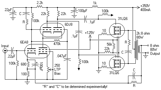

A cathodyne splitter does just that, it splits the phase. It does nothing else in terms of gain. (It also has limitations due to the high plate Zo vs. low cathode Zo, particularly against capacitance and thus frequency response, but I digress.) Thus putting it before or after the required gain stages makes little difference, except in the amplitude you expect it to produce.
So. Let's put it just before the output tubes. Gain comes first, as what amounts to a preamp stage. The output tubes get little drive, which may or may not be an issue - triodes have large miller capacitance, while pentodes escape that, with higher gain to boot. (Certainly, voltage output is not an issue, if you bias and supply it properly. It requires a lot of voltage, since it produces the peak to peak drive voltages simultaneously!)
Now let's put it at the front instead. It produces NO distortion ("none" is impossible, but seriously, I mean, almost total NFB here...). It splits phase and now a balanced amplifier stage is required, taking an extra tube (or two). Balance can be improved using a common cathode resistor, particularly a large one (or a CCS, i.e. LTP). This is important if HF balance is required, especially if a weak (low current) cathodyne is used (assuming triodes (high miller C) for the gain stage, which is pretty much certain). The output tubes are driven well, depending on the driver tubes. But you use two tubes instead of one.
For high gain situations, a cross between the two is used - a preamp front end, usually direct coupled to the phase splitter, which then drives a balanced amp which drives the output. The basic Williamson topology. Unfortunately... it *really* sucks. You get, at best, three phase shift elements in your loop (two pairs of coupling caps and the OPT inductance), making for motorboat city if you aren't careful.
So where does that leave us? Well, a pentode has a lot of gain, so let's use one of those. LTPs are great because they have gain and produce an unconditionally balanced output, even when driven with an unbalanced signal. And we can stand the LTP on top of a tube CCS, allowing us to direct couple the pentode to the LTP and eliminate a coupling cap from the loop. Wow, it suddenly works! And with only *TWO* tubes, at that.
(Well okay, the attached doesn't show *quite* that. You could use the 6U8 triode for a CCS instead, if you do it right. It might cost some extra voltage though.)

Math blows. I'm lighting up a 12AU7.
+400V supply
330k to 100k grid bias voltage divider (approx. 1/4 = 95Vg out of 404V supply)
22k plate and cathode resistors
Single triode (first, of a 6189 to be exact)
Cathode voltage: 104V = 4.7mA and 9V grid bias, seems a lot but it might just be the high supply voltage. Fits the GE 12AU7 graph within 10%.
25Vrms 1kHz applied to grid via 0.1uF coupling capacitor.
Plate output: 21.2V, cathode: 21.6V. (Ripple negligible at <10%, 150mV to be exact.)
This proves middle frequency balance is good. IOW... the damn thing works.
25Vrms applied to cathode via 0.1uF capacitor and 100k series resistor (to make generator appear nearly constant current). 25V at signal generator, 0.42V at cathode. Voltage across 100k = 24.6 = 0.246mA AC, Vk / Igen = Zk = 1.7kohms (a bit on the high side for a cathode follower, but remember it's only half follower).
FWIW, Vp = 4.8V -- amplified as a cathode input amplifier with gain = 21.2dB.
25Vgen applied to plate with same hookup and conditions: 4.2V plate (0.24V at cathode, as a result of plate resistance changing Ip and thus Ik). 25 - 4.2 = 20.8V across 100k R = 0.21mA = 20kohms. Since the plate resistor (22k) is comparable to this, I will dig up the parallel resistor formula to find effective Rp of the tube:
R = R1*R2 / (R1+R2) --> R*R1 + R*R2 = R1*R2 --> R*R1 = R1*R2 - R*R2 --> R*R1 = R2*(R1 - R) and finally,
R2 = R*R1 / (R1 - R)
R1 = 22k, R = 20k (measured), R2 = (20k)*(22k) / (22k - 20k) = 220kohms plate resistance. This is far greater from the approx. 15kohm plate resistance of the tube with a bypassed cathode at this operating point, and indicates 23dB current NFB at the plate (which happens to correspond to the approximate gain reduction of the system).
Now for the on topic experiment: signal attenuation at high frequencies due to capacitance. I will test equal and unequal capacitors.
First: generator at 10kHz, 25Vp-p (since I can't read this frequency accurately with my voltmeter, I will read off the scope). Given the Zo noted above, I will choose capacitors approx. 10kohms reactance; 1nF = 0.001uF = 1000pF will suffice. This is equivalent to 100pF at 100kHz, so is quite reasonable.
Voltage at cathode: 23Vp-p. This is reasonable given the Zo of the cathode compared to the reactance (20% smaller). Voltage at plate: here's what you've all been waiting for: 22Vp-p. Slightly less, but within tolerances of this experiment.
Second: no capacitor at plate, 1nF at cathode. Same conditions. Vk = 23Vp-p, Vp = 33Vp-p. Plate gain increases because the cathode isn't as "soft", reducing NFB.
Third: no capacitor at cathode, 1nF at plate: Vp = 14, Vk = 22V. Cathode voltage remains constant because the capacitor never gave it a second thought in the first place, but Vp is lower due to its high Zo.
Fourth: absurd values, deep into the cutoff region in other words. Generator to 50kHz, 25Vp-p, and 2.7nF for plate and cathode. Cathode: 18Vp-p, with significant slope (discharge) limiting. A rounded sawtooth. Plate: 17Vp-p, inverse appearance.
Conclusions: due to the NFB and condition of it seen by each, plate and cathode Thevenin impedances are widely different. Cathode voltage is nearly immune, however plate voltage can be easily affected, independent of the cathode's actual voltage (due to cathode input amplifier behavior). Because the tube is a mostly one-way device (mostly because remember there was a little feedthrough from plate resistance), plate will not affect cathode or grid voltages.
In summary, cathode current unequal to plate's will cause a difference.
This can cause very interesting behavior, for instance when a cathodyne's cathode suddenly finds itself providing grid current, the plate does a wild bit of movement and your amplifier's output waveform grows a tit on top.
Tim

Hi Tim,
You have done the same "mistake" as many others when you tried to measure the output impedances of the split load inverter, you measured the anode and cathode separately from each other i.e they where unequally loaded. The result you get is exactly the expected one that anode and cathode impedances are unequal.
If you have time you can do what I did when I measured output impedances, I connected different values, (but same for cathode and anode) of high and low load impedances and calculated the output impedance by measuring the difference in output voltage, this give the same value of output impedance as in Preismans article, actually much lower then rp, see equation 12 in Preismans article for actual value.
Another way of realising that the output impedances are equal and much lower then you would expect is to check the frequency response of the amplifier and determine the poles which you will find are located at much higher frequencies then you would expect given the output impedances you measured in your setup.
As you write you have to be careful when using a split load to directly drive power tubes if there is a risk that you go into grid current as the output impedances are affected by unequal loading but this behavior is well known and described by Preisman as well of by Morgan Jones.
There is an unbalance for very high frequencies as the loads will be unequal due to different capacitances but this can be fully compensated for and is not a problem at frequencies below a few MHz in most cases.
Regards Hans

Thus my hint! It doesn't matter WHAT the load is, as long as it's symmetrical, the frequency response at each side will be identical (Kirchoff's Law forces this)- so one is inevitably forced to conclude that the source impedences are the same.
The source resistance is Rr/([mu+2]R+r), where R is the load resistor value and r is the plate resistance.
Edit: Hans, I was about to respond to Tim- you saved me the trouble, thanks. Tim, go get two 10x probes and a two channel scope. You'll convince yourself quite quickly.

tubetvr said:You have done the same "mistake" as many others when you tried to measure the output impedances of the split load inverter, you measured the anode and cathode separately from each other
If this were a newsgroup you'd be plonked by now. You can't be convinced so nuts to you.
The whole point of Zo of plate and cathode is because, if for some reason, the impedances ARE mismatched, your output goes to pot. PERIOD.
With a circuit like this, where the cathode effects the plate, you can't see an unbalanced output without unbalancing the load.
You'll note I conducted the experiment with absurd values of capacitance, namely 1447 ohms reactance, for both plate and cathode, and the result was: GUESS WHAT, the voltages are EQUAL.
Sy: I have a dual channel scope but didn't feel like connecting the second channel because I, like everyone else, already know that the signals are equal and opposite (minus the unbalanced load situations).
I will leave it as "an exercise for the student" to determine the phase of the signal measured on the opposite terminal when testing Zo. Reading what I have, the results may suprise you...
Tim
Tim,
I must assume that you are not interested in knowing the output impedance of the split load inverter when it is working as a phase splitter.
Can you then tell me how you calculate the poles in the frequency response that comes from the phase splitter output impedances and output tubes input capacitances?
Regards Hans
Regards Hans
