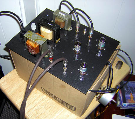

Sure, here are a few shots of the GG line stage. I've been wondering if there could be a grounded gate mosfet version put together to be its solid state equivelent???
Mine was hastily built on a flat 6061 alumnium plate 3/16" thick that is finished with Hammerite Black Hammertone paint. Yes the caps are 5uf PPMFX bypassed by .1's and 150K feedback resistors. The larger caps seems to give the bottom end more solidity. The transformers for the plus and minus 200 volt supplies are Stancor P6406 and the filament is a Triad F344X. All of the parts were I bought surplus locally including the 6189W Sylvania made JAN tubes which I highly reccomend you track down and purchase because they have little to no microphonics which are normally very bad in the every day 12AU7 tube.
The attenuator is a very old Daven 10K T type that I convereted to a ladder style 50K. As soon as I have some time the plans are to build a coco bolo or some other exotic wood base for the plate and the attenuator will be mounted on the front of the base. This will eliminate the unsightly fry sauce box that it now resides on.... the label says best if used within 30 days..... hummmm....
Those that need the GG schematic can find it in Bruces book "Audio Reality". I had to buy it to get the schematic too and you will also need to since the design is Bruces property!

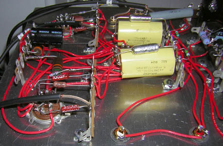

The audio end of the bottom of the plate....... Although there are a number of high quality 1% resistors there are also an equal number of aweful carbon 2 watt jobs in there.... nothing really too exotic seems to be required to get top notch performance and supposedly little to no gain in performance would be had by using higher quality parts. I do intend to experiment with a 12AU7 based CSS in the near future and possibly to eliminate the zeners in favor of gas regulator tubes. Zeners although cheap are somewhat inherently noisy.....

The power supply end of things. The filament regulator is mounted to the small finned heat sink. That will be eliminated and mounted directly to the chassis as soon as I get some insulated mounting hardware.
The feedback resistors are in the lower center of the photo. I located them in an easy to experiment with location!! For my system the 150K value seems best but anywhere form the original value to 175K will give you minor changes in the bottom end. Also let this preamp break in for at least a week before making any major judgements on overall sound quality. The break in is somewhat dramatic and the unit will under go a number of shifts and changes in its sound before it finally settles down. Sound staging and clarity are incredible.
