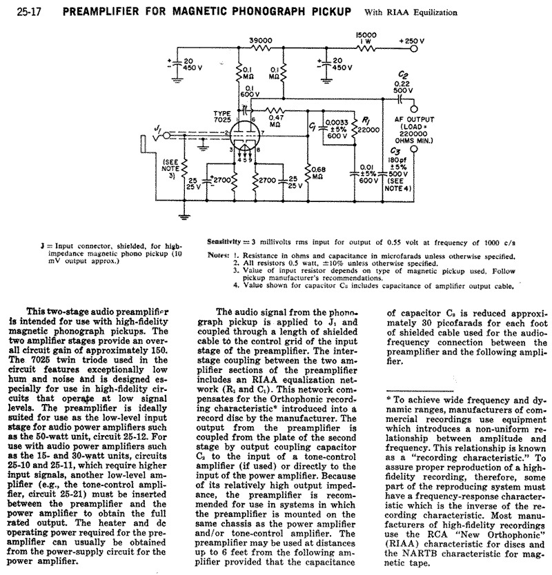

Look in the back of the RCA tube manual. One of the sample circuits is a tube phono preamp with RIAA curve. it is based on one 7025. (12AX7) I would think the 12AU7 was a bit low gain for the application. Very simple circuit. You would need one per channel. SO two 12AX7 and a handful of small parts. You also need power supply.
You could probably make something with one 12AX7, but I don't see how you could get RIAA that way.

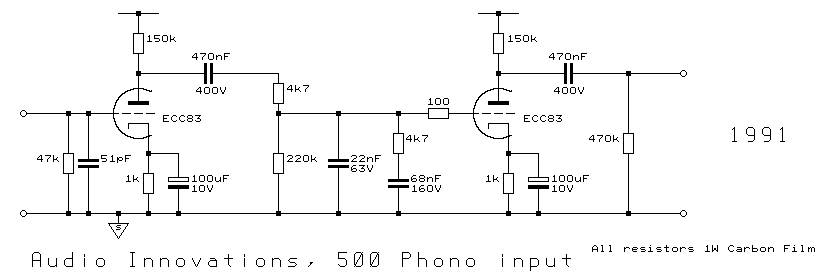

Gday.
Ohashi looks interesting,
with 3x12AX7/ECC83 and 12. res/log , 4. cap`s
it`s "low part". Haven`t a clue about the sound,
but i assume minimal use of passive components
can speak for quality. It shouldn`t sound worse than AR SP3
i reckon. Have you looked at the phono stage of the
Audio Innovation 500.

planet10 said:
It lacks the undocumented time-constant, but here it is
From the 1966 RCA Receiving Tube Manual.
dave
Are 12AX7 close enough to a 7025 for use with this schema? If not, is there an RIAA schematic for 12AX7? I'd be looking for a simple design, one 12AX7 per channel, no output transformer and about 30-40dB gain (for MM phono).
Any leads or info is always appreciated.
Gio.
A 7025 is a 12AX7 -- supposedly selected for higher performance, but in practise the variations are such that it is a no care.

The "RCA circuit with RIAA Eq"
I have that('66 RCA tube manual), that schematic, and I would like to consctruct that phono preamp to connect my phonograph directly to my headphone preamp.
I can build it; it is a very simple circuit.
