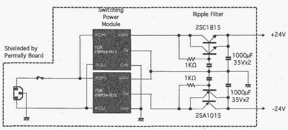

Would this ripple filter work?
Yes, that ripple filter would work. The current sharing of the parallel transistors should be improved with emitter resistors and the ripple tolerance is in the order of some 600mVpp only. It is a low power supply as each transistor can handle a maximum of 150mA.
The circuit needs modification for higher power.
NB: Evidently, the filter is not without a voltage drop (and power loss). 24V in will leave some 23.2V out.

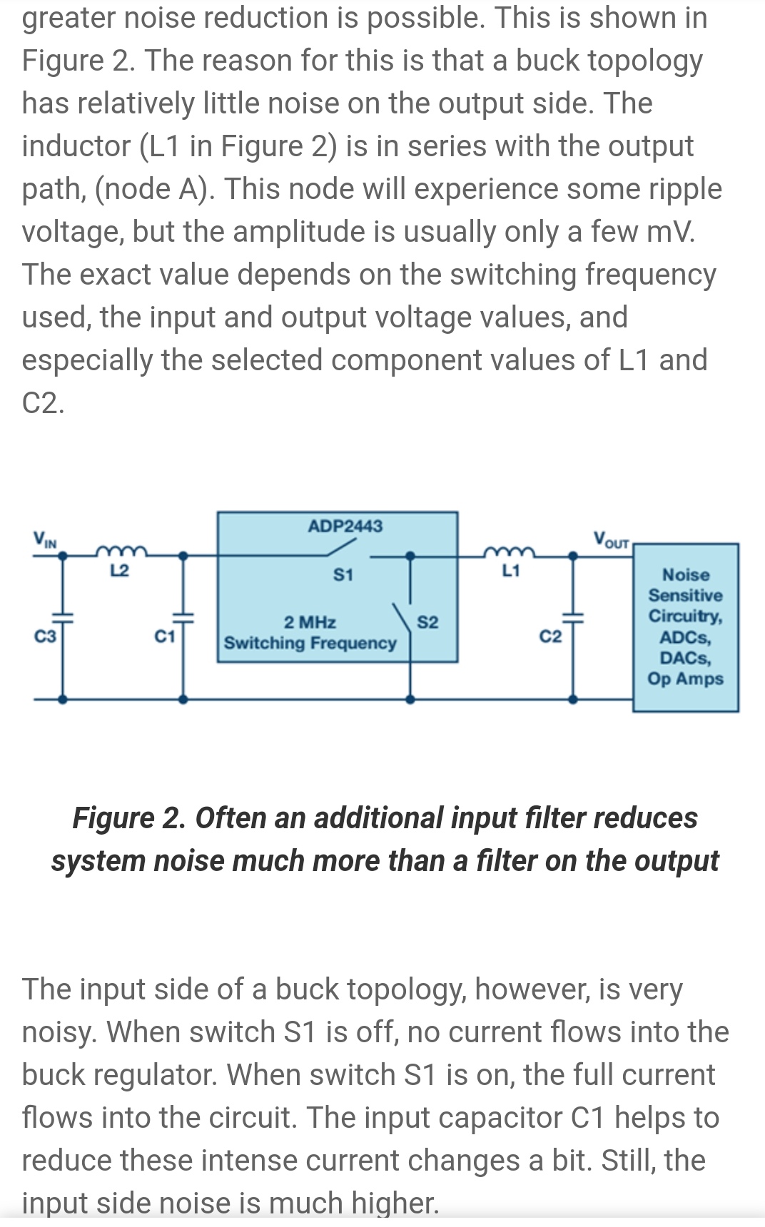

Any advice as to how measure / verify such increased ringing?
Approach #1 is network analysis.
Low cost network analysis may be achieved with prototype geometrically representative of final design, square wave generator of suitable rise time, square wave injection through suitable impedance [such as to make injection inductance negligible], and voltage waveform analysis through oscilloscope of suitable bandwidth and resolution as to overcome attenuation due to injection impedance. If square wave with rise times exceeding speed required by source and load looks smooth, filter is good.
High cost network analysis involves equipment specifically designed for doing so. Often five digit price.
Approach #2 is network heuristics.
Each component package has characteristic inductance. PCB traces, wires or any conductor geometry has characteristic inductance and capacitance. Each capacitor type and size has characteristic ESR to capacitance / size ratio. This data can be derived from approach #1 applied to a representative set of components and annotated in proper Engineering Notes, allowing to make an accurate first guess for new designs or modifications. There is a wide selection of software to simulate RLC networks. From latest LTSpice to old Electronics Workbench.
Initial rule of thumb, which can and should be verified by every experimenter independently, is that 1nH/mm is an accurate first guess for component lead inductance and PCB track or wire inductance (no ground plane or shield). This figure can improve to 1nH per few cm with close ground plane as in 4+ layer PCB.
