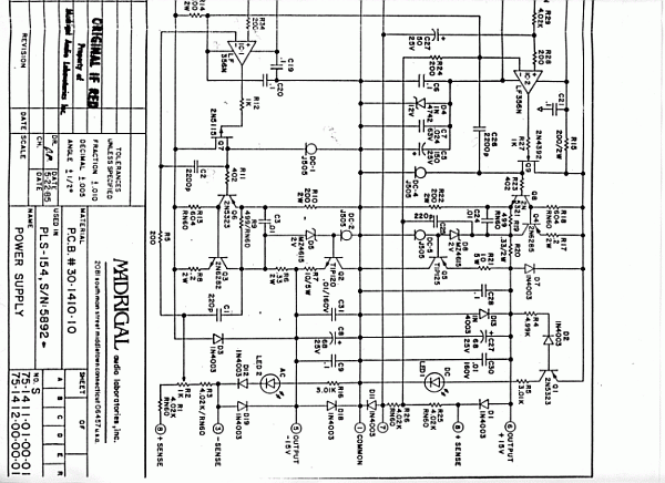

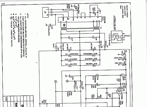

Dual Tracking Regulator
Per-Anders, I knew Quirck was right....
You really should consult Horowitz to see any advantage......
Here is an example more to your taste (more parts, complicated design, not SMD though):
It is for the Mark Levinson ML-7 preamplifier.

peranders said:
.. but why has it to by symmetrical in the first place!
maybe the variations on the ps rail aren't transmitted to the output in a symmetrical tracking ps
imagine an opamp, AC coupled signal going into it.
If the ps rail are -12 0 +12, 0V DC at the output
if there's a variation on the ps rail, but the ps is a tracking one, the rails become -10 0 +10, still 0V DC output
but if the ps isn't tracking, the rails can become -8 0 +12, and here you'll have DC
Well in case of extra load on either the positive or negative line, the regulator will regulate the voltage back to the correct level. Therefore called a regulator.
You will never get +8 0 -12 V!
The load regulation is something like 30 mV from 0 mA to 1 Ampere.
So you will get 11.97 0 -12V (if your op-amps use 1A on the positive rail and 0 mA on the negative rail) ((in that case i guess you probably have DC anyway, but not from the regulator offset)) :D
Another thing: if we are talking about a tracking regulator, which by some is defined by the negative rail tracking to the output of the positive rail, what happens if the extra load happens to be on the negative rail. Will the positive rail then track that change?
:cool: right back :D
