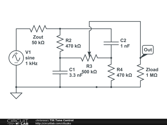

Various Questions to the kind of Tone Control from Modell 44
I have various questions to follow preamplifier:
Quad
1) the tone control that works here is an is an alternative to James-Baxandall's passive tone-Control network.
Which colloquial term exist therefore and how I calculate the values (calculation steps) ?
2) Who can tell me a link for curvature diagrams and schematic or can upload the graphs and schematic?
Thank you in advance for the appropriate advices.
Quad
tiefbassuebertr , see in your link Quad34 preamp, service manual, there is very detailed description, how tilt and bass control work.
Simpler and better variation of tilt you can see in this article:
Designing A Pocket Equalizer For Headphone Listening | HeadWize
Here is service manual:
http://www.meridian-audio.info/public/quad_34_service_data_manual[1582].pdf
inside are schematic, tone control description, everything.

Implement an audio-frequency tilt-equalizer filter | EDN
the colloquial term is "Tilt-Equalizer" or “tilt” audio-tone control
The tilt control tilts the frequency content of the audio signal by simultaneously boosting the treble and cutting the bass frequencies, or vice versa. Only one knob is needed to tilt the frequency response around a pivot frequency, FP.
How I can reduce the elements, if I want to realize only the possibility of boosting the treble and cutting the bass frequencies from the flat-position (the opposite case I don't need) ??
In this case I am looking for calculating by a portal like that for active crossover networks - go to
http://www.beis.de/Elektronik/Filter/ActiveLPFilter.html
Maybe one of the members know this.
Additional I want to shift the lower cut-off frequency (center- resp. pivot frequency in the genuine topology to adjust in both directions).
Thank you for advices.
to have only bass cut and hi boost add an appropriate resistor at the right of the potenziometer, the sum of the pot. value + the new resistor must bee like the old value of the pot.;
to shift the pivot frequency see my EDN article:
With that formulas you don't need spice try-and- errors loops. Asymmetric responces are possible !
