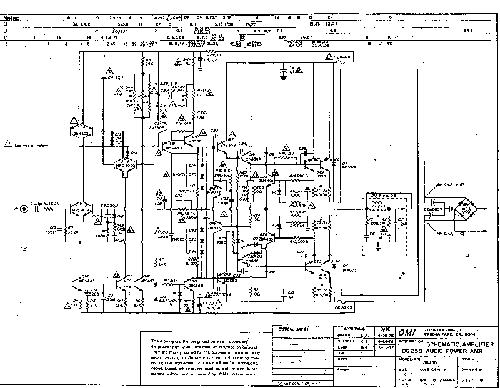

Scott, I would be willing to pay you for that schematic. I have been looking for one for the last two years.
BTW, the main power output transistors are nolonger being made. I have not tried to look for a substitute. Many of the other transistors in there may not be replaceable.
I have done a trace on the board with a scope (the ch. that never worked). The only thing that I found wrong is a diode was causing some unusual distortion. I only had about an hour to work on it though.
Let me know if you need anymore info on the amp.
Thanks David
Found it
I have a nice big clear scan I can send you, this is just a tease post of a tiny one.
I have this amp and the schematic too, but like yours my Quattre was broken when I bought it. I have been trying to restore it, but it continues to break. I am about to conclude it is not stable enough to be worth the effort, but the chassis and power supply would be a good base for something else. If you have better luck, I'd love to hear about it.

And Scott Nixon I know your here. you seem to be the only person in the world with a schematic. Would you please post it I was so deperate I tried enhancing and enlarging that teaser you posted. Be kind
