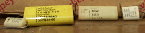

Hi all. I'm hoping some of the forum gurus who can identify caps on sight (and faster than a speeding bullet no less) can help me out with some new finds from the bargain bins. Anyone know the composition and/or sonic attributes of any of these caps?
From left to right:
0.33uF/250V, ??
5uF/100V, 2%, West-Cap WF70U1505
5uF/50V, 10%, TRW X663F
0.1uF/50V, 20%, TRW 8336

Most of the caps you find surplus are Mylar also know as metalized polyester. TRW is now ASC.
http://www.faradnet.com/catalog/company/asc.htm
This might help to identify cap types also:
http://www.capacitors.com/pickcap/pickcap.htm
Alot of what a cap sounds like from construction rather than dielectric. IMB usally makes very good caps and the Sprauges and TRW are good caps also. You just have to listen to them. If you can find Electrocube brand caps they sound pretty good also.
European caps like Wima Rifa and ERO are also very good and are often marked for dielectric type:
MKT- metalized polyester
MKP- metalized polypropylene
MKC-metalized polycabonate

tiroth,
can help with the Mica colour code
(your 3rd pix, lower left corner. the brown square thing: El Menco, Cornell Dubilier, Sangamo, Aerovox or similar).
code has 6 dots, can be either RTMA or JAN or (ancient) RMA code.
Colours indicate same numbers , tolreances, multipliers as with resistor colour code of nowadays.
Capacitance is in picofarads (pF or µµF)

Those ancient micas can be crap and also be extremely good. Before you rely on the voltage rating, measure each and any sample. They may go boom and take your cherished output tubes with them to Nirvana. SS use is uncritical, Best use: shunting PS electrolytics and coupling caps. Also use them for FB and phono EQ. but by any means, compare them to good polystyrenes or polyprops.
General hint (exception: PS) use micas in homoeopathic doses; you would not like overdosing sonically
