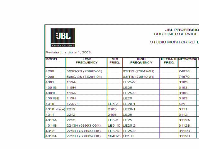

I have been away from DIY for many years but decided to try and build something out of a couple of JBL 2213H, LE5H and Dynaudio D21-AF as a clone of the famous monitors. I have these drivers since 15 years and thought I might as well do something useful with then if possible.
I wonder if anyone knows about the crossover design or even has a schematic of the old studio monitors from JBL.
Or maybe any alternative ideas?
I'll be happy of any input regarding this subject.

here are the different componetts of 4311 -4312. (att)
regards dieter
the schematics are:
http://www.jblproservice.com/pdf/Network Schematics/
regards dieter
the schematics are:

Dear friend.
I saw your post.And.I could not help in giving you this information.I been having nightmares about crossovers.The final conclusion and as a rule:
1.never change the coils or inductors in the original crossover.
2. Never think that ...by having the original schematics you will be able to have your speakers back at 100%. it does not work like that.I have found out that the majority of schematics out there are not 100% accurate as the original speaker.However ...is close but not 100% accurate.I can actually say this to the JBL on their faces.(shame on you JBL)so you dont blow your speakers they give you measurements on the crossovers.The safe ones.
3.I imagine that you want to tweak the crossovers right?
if so. Just upgrade the capacitors to a good quality polypropylene.Also.if the crossovers came with bypass caps...do not remove them.
4.resistors can be upgrade too.maybe to MOX or a better quality out there.
5.Keep same values as close as possible in caps and resistors ...otherwise you will have a total different speaker.
good luck.
