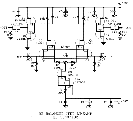

Hello, Charles Hansen ,Can you recommend the best of power supply for the Erno_Borbely's
EB-2000/402 SE Balanced Jeft Lineamp?
Thank you very mach.:)

Hello -
I'm not sure why you're asking me instead of Erno Borbely. This circuit is not the kind of thing that I'd recommend. However, I can make a couple of comments:
1) The power supply rejection ratio of this circuit isn't very good, so its performance will be quite dependent on the quality of the power supply.
2) It is possible to blow the 2SJ74s used in the output stage. These are rated at 25 volts and if the circuit is running up to the clipping point, the full rail of 36 volts will be applied. You might try reducing the supply rails.
Hope this helps,
Charles Hansen

I mean to find an excellent power supply circuit that is used in Erno_Borbely's EB-2000/402 SE Balanced Jeft Lineamp.
Since the audio circuit is zero feedback, I would also recommend using a zero feedback power supply regulator. For an example, read the thread:
http://www.diyaudio.com/forums/showthread.php?s=&threadid=33191&highlight=
Especially read posts #53 and #54. You will have a nice sounding regulator that way. Good luck!
