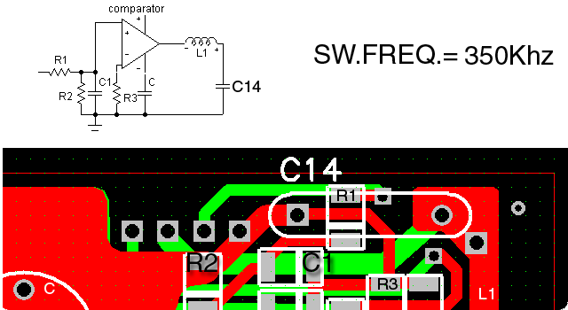

I'm currently doing some simulation on a Class-d circuit based on Bruno.P's patent. I'm just curious- what is the success rate in designing/bulding a high performance class-d amp. here in this forum? It seems "fairly simple" to design a conventional class-d amp. (triangle-wave-->comparator...) , but these self-oscillating animals might be much harder?
Any hints?
Thanks,
Anders

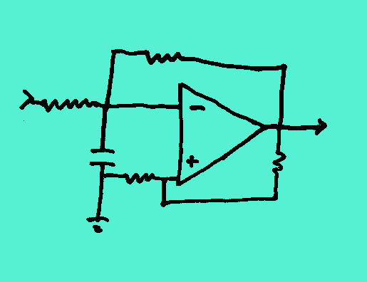

here's a simple approach....

I have a "working" schematic which have some problem with shoot-through and that measures about 12% THD right now. I have some problem with getting rid of the switching waveform from the audio output. I will post the schematic soon for comments if you're interested.
The reason for my original post is that I don't really understand why no DIY:er has tried the self-oscillating type when it seems to quite doable by reading the Karsten.N thesis and Bruno.P's patent.
Anders

As I told you before- I'm new to this business, but do I really need to synchronise the switching frequencies? I guess you mean that i.e. the left and the right channel wouldn't oscillate at the same frequency. Do they have to? Can you notice if they differ a few percent?
Anders
A few percent could indeed be even worse than a large difference ! This is because they might cause intermodulation products. This all depends on construction, PSU decoupling etc.
I guess this would be a problem even in non-self-oscillating designs as long as it runs from separate tri-wave generators. The problem should be solved by minimzing the coupling between the two channels (by distance and by proper PSU design).
Right now I'm having problmens with shoot through. I'm not sure if this is because of imbalance in the circuit, or if I need to incorporate some dead time circuitry.
This is getting interesting!
Thanks,
Anders

You cannot measure THD in the simulation program without lowpassfiltering extremely hard because of the same reason that you lowpass filter a signal before A/D conversion. My own classD amplifier measures 0,0008% at 1kHz 1W with AP but shows 20% or so in a simulation. Even with third order low pass filter after the second order output filter the simulation shows about 0,5% or so. Don´t really kno why.
In order to reduce shoot through, make sure that the turn off transistor that you use is a high beta type with large bandwidth. If the bandwidth is too low the beta will drop, maybe down to unity, at the switching speeds you are trying to obtain. You will allways have some shoot through though, otherwise the distorsion will increase.
